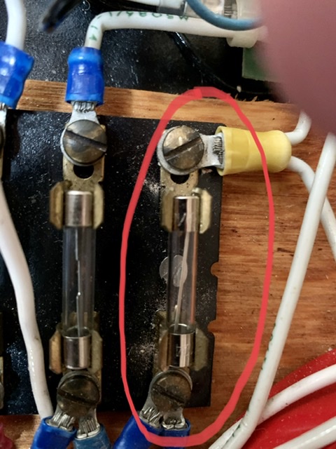

I have a cartridge fuse connection that when the fuse is twisted the connection will disconnect then reconnect if twisted a bit more. I have tried several fuses, including new Blue Sea fuses, but the issue persists. I also have tried filing the brass(?) connections. Any suggestions to fix this issue?

Stationary connector blades riding on the slightly larger diameter glass body of the fuse? Bend blades slightly away from the fuse to get them clear of the glass body?
Mar 6, 2008
1,492
It appears that this is not a suitable solution for a boating environment. Replace the entire fixture.
There should not be any interruption of current when rotating the fuse
The fuse itself may be bad. Replace and see if it cures the problem.

Are you sure there are no cracks or loose points in the blades, wiring etc?
Pull the wires off and ensure the terminal screws are clean and the crimps on the ends of the wires are solid etc.
I like that theory. It looks like the blades are individually mounted, not a single unit for the top and bottom, and at least the top part has an oblong mounting hole, so it could be extended further from the bottom. Extending them will help ensure the blades aren’t being held off the metal by the glass.

I use a product called Deoxit D5 that comes in a spray can. Been using it for many years because the can lasts for ever. Good for the fuses and also for things like flashlight battery connections. Just word of caution, is is very penetrating, and I have ruined a bathroom scale and a weather station by getting it into the LCD display, so better apply to a cloth and then to the terminals.

Can you tighten the screw so the fuse holder does not twist? If unable replace the fuse holder.
I'd look at this since you already have tried different fuses and cleaning the contacts.

It looks to me like you have a fuse holder problem rather than a fuse problem. If you just want to resolve the existing problem you have then you can try replacing your custom fuse holder with a single fuse block.
Eaton Bussmann S-8301-1-R Fuse Block,0 To 30A,glass/ceramic,1 Pole .
A course 30 amps is the max fuse you should use in that holder you could also install a .5 amp fuse in it if that's what you wanted to do. You may also want to put in a new multiple fuse block that would handle each of your existing circuits with new connections to avoid this type of problem in the future. On the other hand I also notice that it doesn't appear to be approved wire for your circuits so you might want to look at that also. Just for good measure I would like to add that this may appear to be a short circuit problem and even though it may not be, if you were to get a boat that was about 3 feet longer then I think all those problems will be resolved. YMMV
