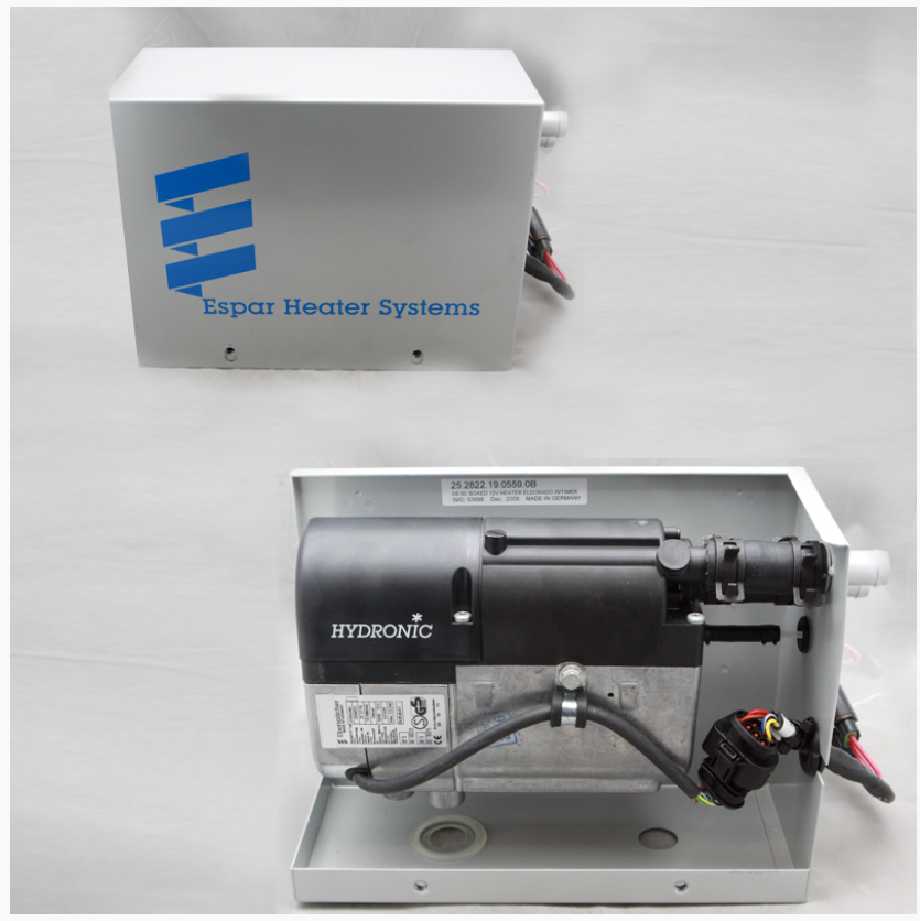

I am also looking at there BINAR 5S which is a hydronic boiler that looks to be the right size for a C30. I have hydronic heat in my motorhome and love it.

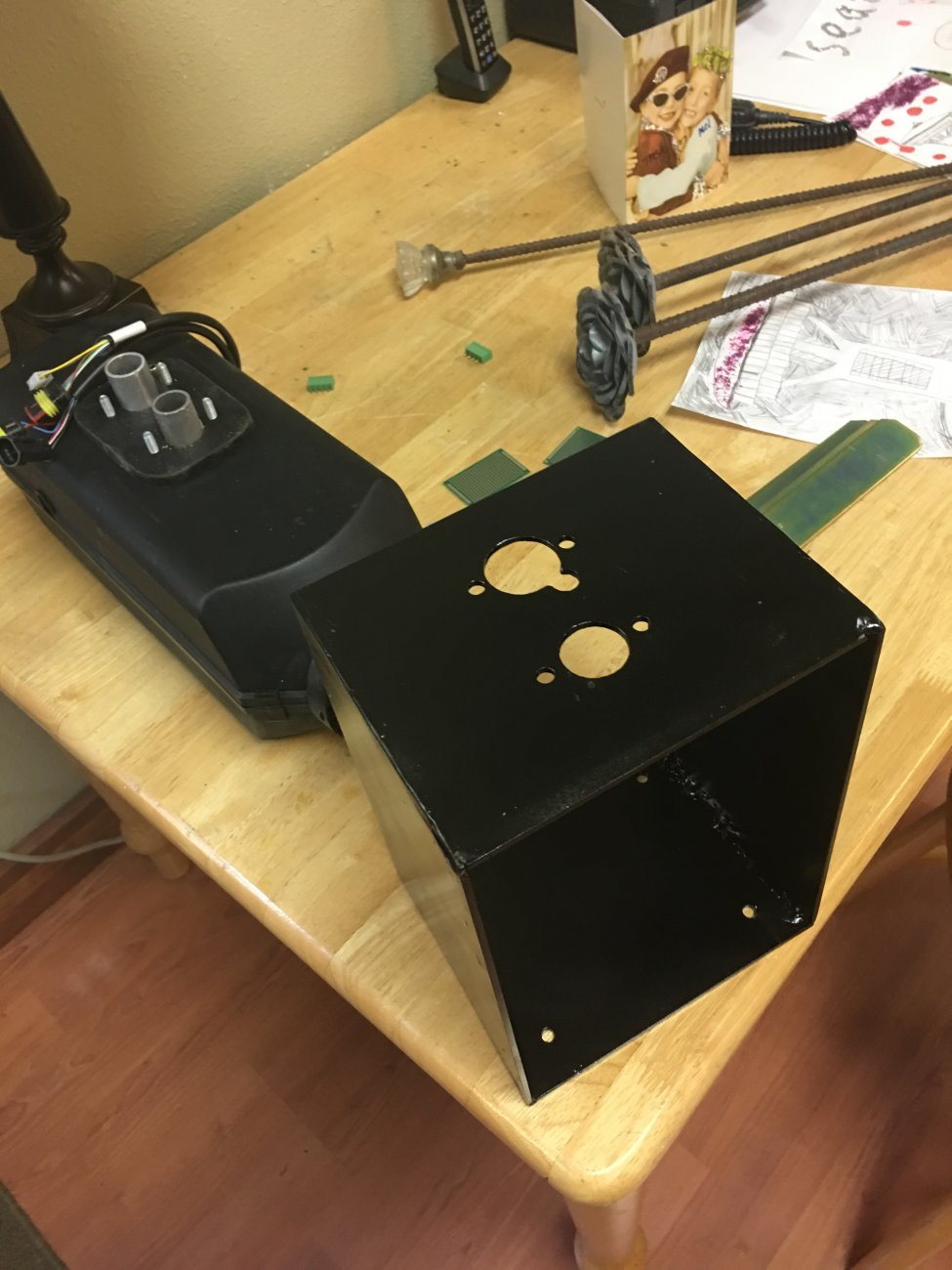

Saw the soot video so will be sure and run full out every day. No experience yet with it, just fabd a mount and will start pulling vent ducting and wire tomorrow
I used my cnc router for the holes then mig’d the Al pieces inside and out. A coating of Cali par paint to finish off.
I’ll mount it just forward of where the port cockpit seat starts and the top of the bracket mounts to the underside of lazerette floor.

I am now thinking about going a different route. I had planned on installing a Wallas GB30 which is $2500 for the full kit. Now I think I might go hydronic with this 17kbtu boiler. 2 cabin heater with 2 outlets are about $250 plus 50' of 3/4" water heater hose.

Stu, Espar S3 D5E.
Mark, If you size the boiler properly you can minimize the short cycling. The unit I am looking at has variable stepless heat output from 8000 btu to 17000 btu. That way it can throttle back to provide longer run times. As you said, if you have a good exchanger in the water heater, it can recover stored heat to keep the burner from coming on too frequently.
Les, the S3 D5e has a max dc consumption of 4.2amps (6.0amp startup) and drops to 1.9 at low burn. The two cabin heater one with 1 outlet and the second with 2 use 120mm computer muffin fans rated at 0.5amp and I can improve on that by getting better fans. All of this is much better than the 18amp startup and 7 amp running that I got from my old Arctic and it short cycled terribly with 5 on 10 off most of the time. As for ease of install, that is one of the big reasons for the hydronic. The case will bolt into the same spot as the arctic and it is easy to run 3/4"ø hose. We want to have heat in the head and getting a 3"ø duct + insulation under the icebox and around the red dot under the oven was not looking very doable.
