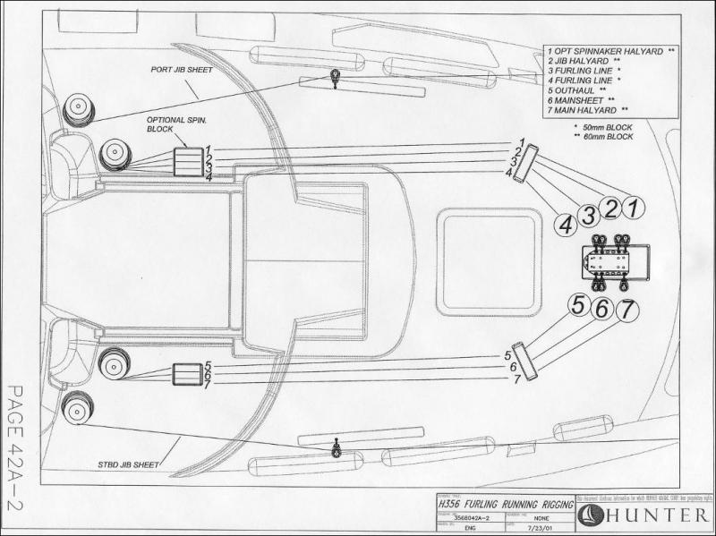

I just purchased a Hunter 420 Passage with an in-mast furling system. The previous owner never ran a halyard from the mast to helm so when you furl the mainsail, you have to do it on the mast itself. How do you run the halyard from the mast to the helm so you don't have to go out to crank in the mainsail? It is a 2003 Hunter 420 Passage CC. Thanks.
