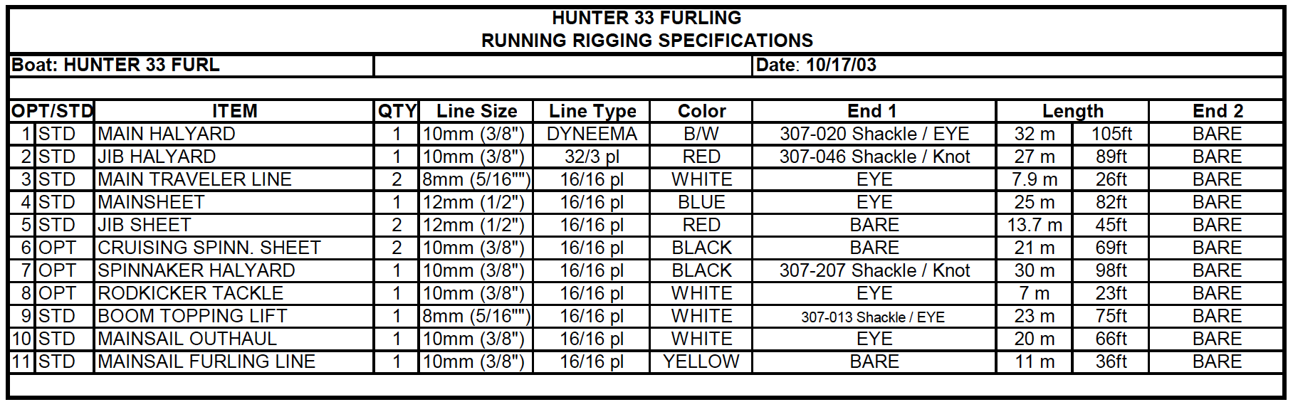

I am planning to replace main halyard on my H33 2006 with furling in mast. Original was, I think, some kind of premium like Dyneema, but I am not sure. Will the 3/16 polyester braid be sufficient? I am just cruising on Georgian Bay /Great lakes.
Also, does anyone know the length required? I am away from the boat and cannot measure right away, but would like to purchase the rope before going to the boat next week.

The manual for our boat specifies a dyneema core with a polyester cover. A polyester double braid would be too stretchy for this application and you would need a much larger polyester line for similar breaking strength. If the high performance line is putting a pinch in the wallet, take a look at Robline Admiral dynema with a polyester cover. Same performance as New England Ropes at a better price point. NER manufactures both lines.
If you don't have a manual you can download a copy from here:
