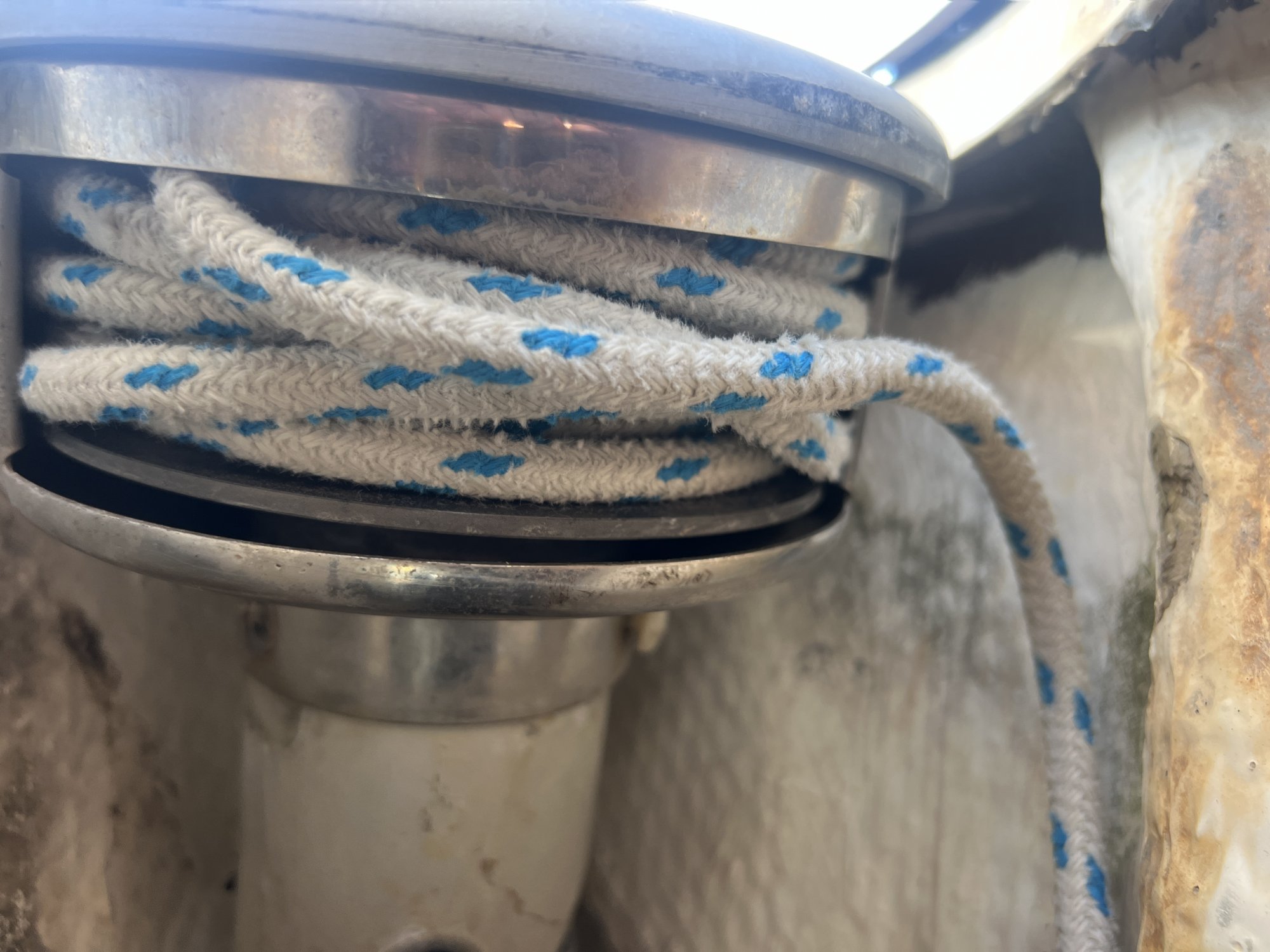

My current furling line tends to bunch up in the drum and bind a little bit, which makes unfurling and furling a little sticker than I would like. Any recommendations on how to efficiently fix this? I believe I have a 5/16 line currently in there. Should I just core a section of it and create more space in the drum that way? Or am I better off just buying a new thinner line as this one is a little tired? Would washing the line help?

On my Harken they supply 7 mm Single braid polyester (9/32). That would likely work on your furler.

I would suggest stripping out the core on the first 15 -20 feet of your furling line. You will still have plenty of strength and with this amount first winding on / off your furler there will be no difference on the portion you handle. For many furlers this is a suggested process. Good luck

New line…. Will make a huge difference.
Mine looked like that, and I had problems with it not rolling into the drum. I replaced the line (same size as was in there), and it worked effortlessly after that.

But...but...but, that line looks WAAAY TOO BIG for the amount of space in that drum. I have a 34 foot boat with a ProFurl system and use 3/8" line which last I checked is bigger than 5/16" (3/8 = 6/16, right?).
Smaller line is almost a necessity in your case, unless you core for the space limitations you have. Many of us use 3/8" for the "hand" RATHER THAN the strength. As Steve alluded too, strength is not usually an issue, whereas "hand" vs. space available in the drum is what your "deal" seems to be. You might end up with thinner line, so just use a glove when furling.

It appears that the line needs to be pulled tight while furling. And a thinner line will help. I use 3/8" with gloves.

My furler seems to be the 800, which is rated for 5/16 or 3/8. I wouldn’t imagine the PO would have put oversize line in, but it seems better not to make assumptions. What’s the best way to measure/confirm the line thickness? Put it under load and measure with calipers?
13,445
The line looks too loosely wrapped on the drum. Don't let the jib fly freely when unfurling, put some tension on the furling line to get a better wrap. Also check the lead to the drum to ensure it is fair and at the correct angle so the line wraps compactly. The instructions for the furler should specifiy the lead angle. Generally, the line should feed to the middle of the drum and at a right angle to the drum.
If the line is indeed a ⅜" line, replace it with 5/16". that 1/16" makes a big difference in the amount of space it takes up on the drum. Stripping the core would be my last choice.

Thanks for that. I will double check the block placement and line angle being fed to the furler.
I’m planning to pick up some new line tomorrow but want to confirm the length and thickness of the existing line first.
What’s the best way to measure/confirm the current furling line thickness? Put it under load and measure with calipers?

My furler develops problems with overrides after the line is 3 or 4 years old due to stiffness of the line.. I use 5/16” that is recommended by ProFurl for the size furler that I have. Definitely use gloves or take one wrap of furler line on a winch to provide slight tension on the line to control the coiling on the furler drum when unfurling. Judging from the size of your boat, I would use 5/16” line. It’s difficult to measure line that is several years old because of swelling / fraying.. The appearance of your furler line in the photo indicates that it’s pas time for replacement
You should notice an immediate improvement.
This
All the posts offer good suggestions and tips but @BigEasy 's post points to the main cause. New smooth line will lay smoothly and tighter on the drum than old, rough, swollen line.
