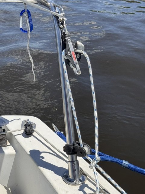

The previous owner of my boat installed a swiveling mainsheet brace with a cam. It works well enough, though maybe a bit overkill. The nice thing is it allows me to furl/reef/unfurl from multiple positions. And I like the block and cam because it allows me to maintain a lot of control over the line. Additionally, I can flake the line and hang it on in the arm..
This is not the swivel base used but it is representative. Mainsheet swivel base with cam

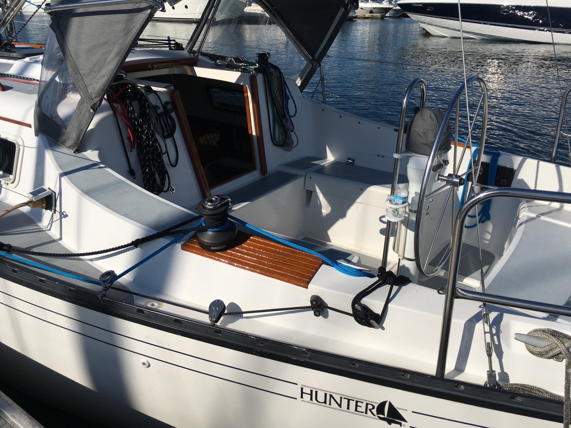

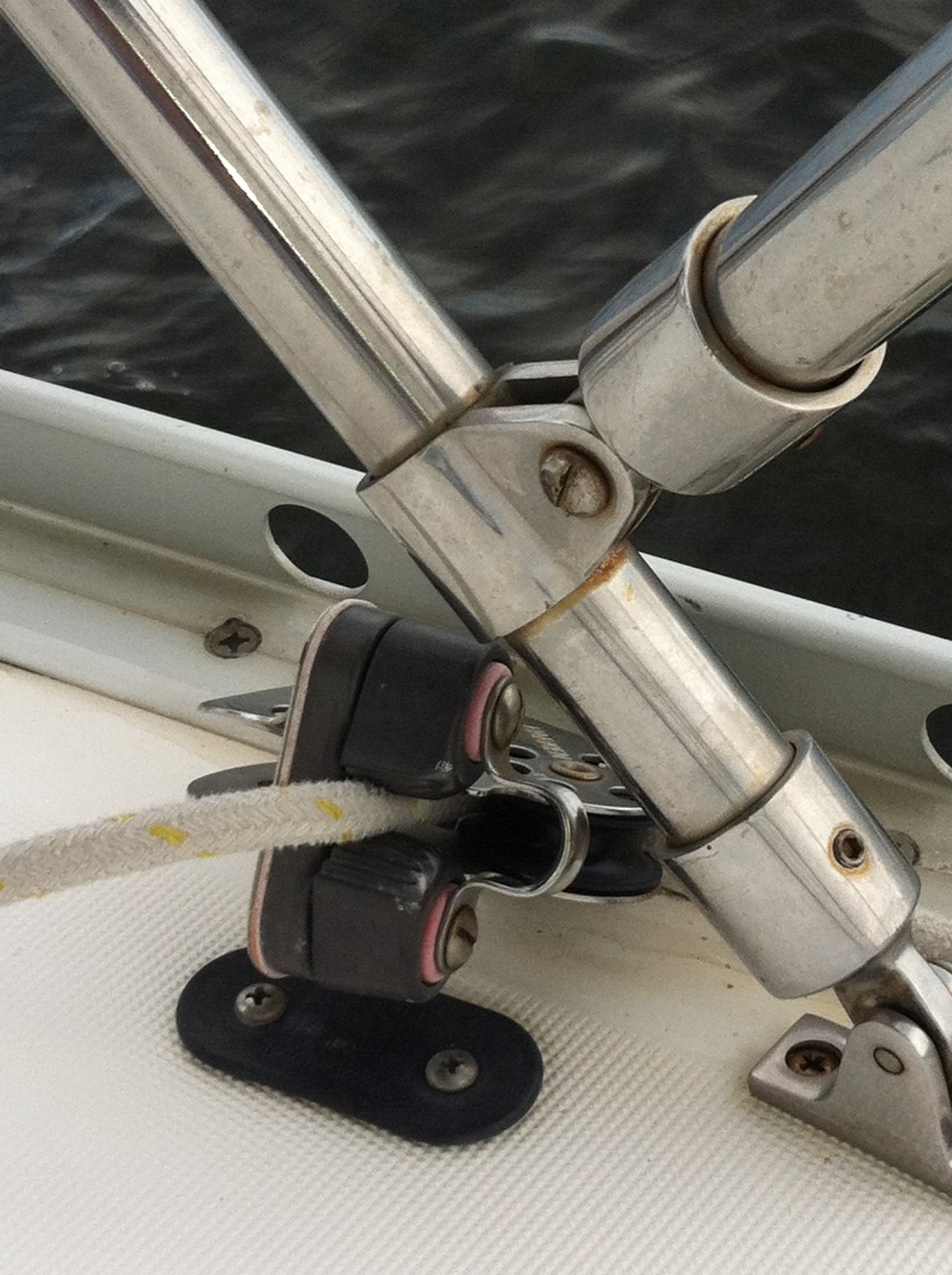

My furler line runs through a ratchet block at the toe rail and to a cam cleat on the outside of the coaming with a G10 backing plate and an angle wedge. It used to go a jam cleat on the outside of the coaming, but I now just use that to hang the coiled furler line on because I sometimes lost control of the furler line if I uncleated the line under too much load. In addition to being quicker to cleat, what I really like about the cam cleat is that if the line is under more load than I can control in my hands, it‘s more difficult release and that tells me to reduce the load on the line before uncleating to reef or furl in my genoa. I never ever winch my furler line. Too much chance of doing damage.
With the line cleated and hung on the old jamb cleat in addition to the cam cleat, there is zero chance of accidental release that would shred the genoa during a dockside storm.
Exact cam cleat location may depend on whether you‘re handling the line from the helm (I’m a frequent solo sailor.) or a crew member is handling it forward of the helm. Mine happens to be at a location that can work either way, but is probably a bit better for helmsman control.

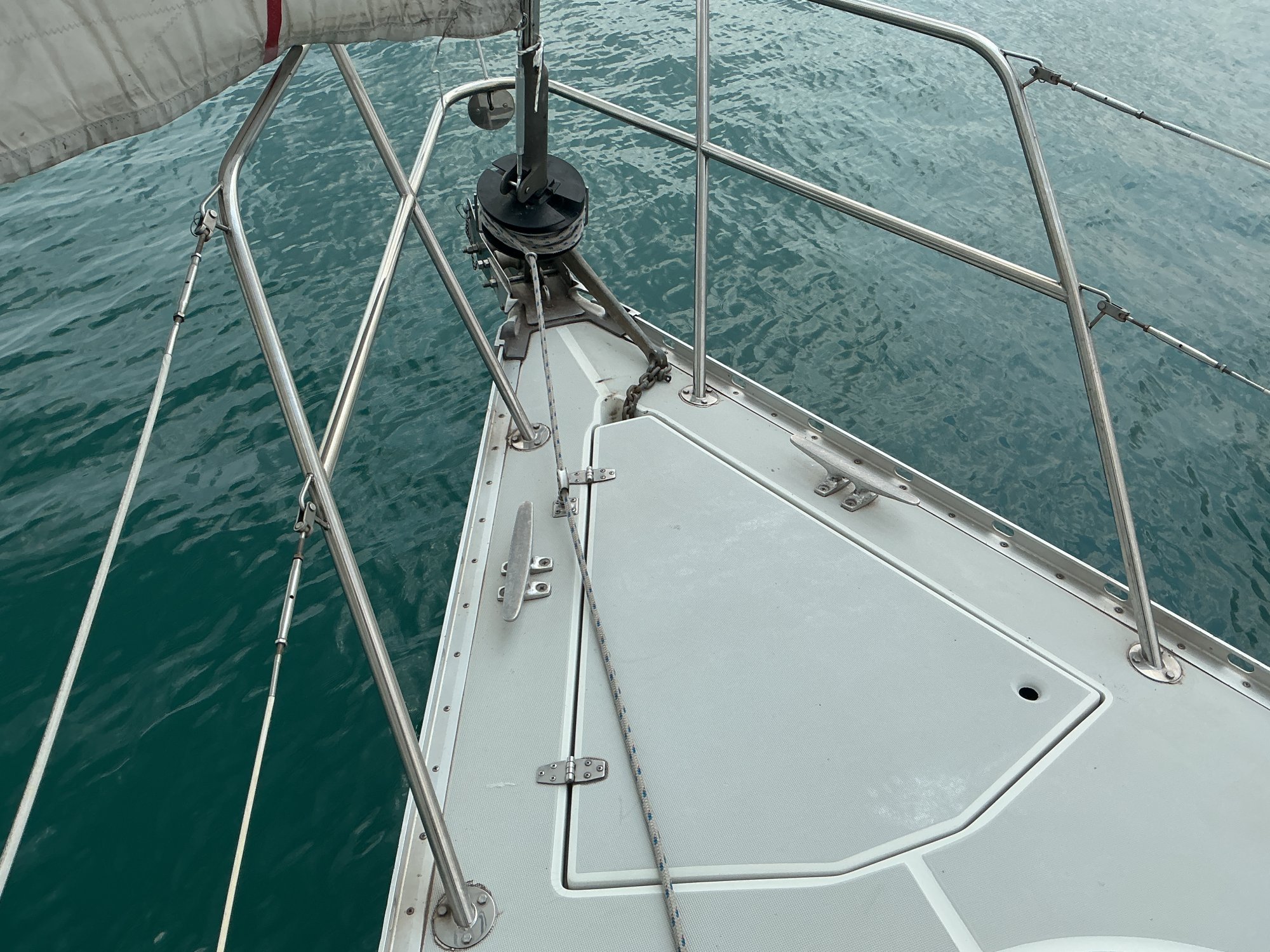

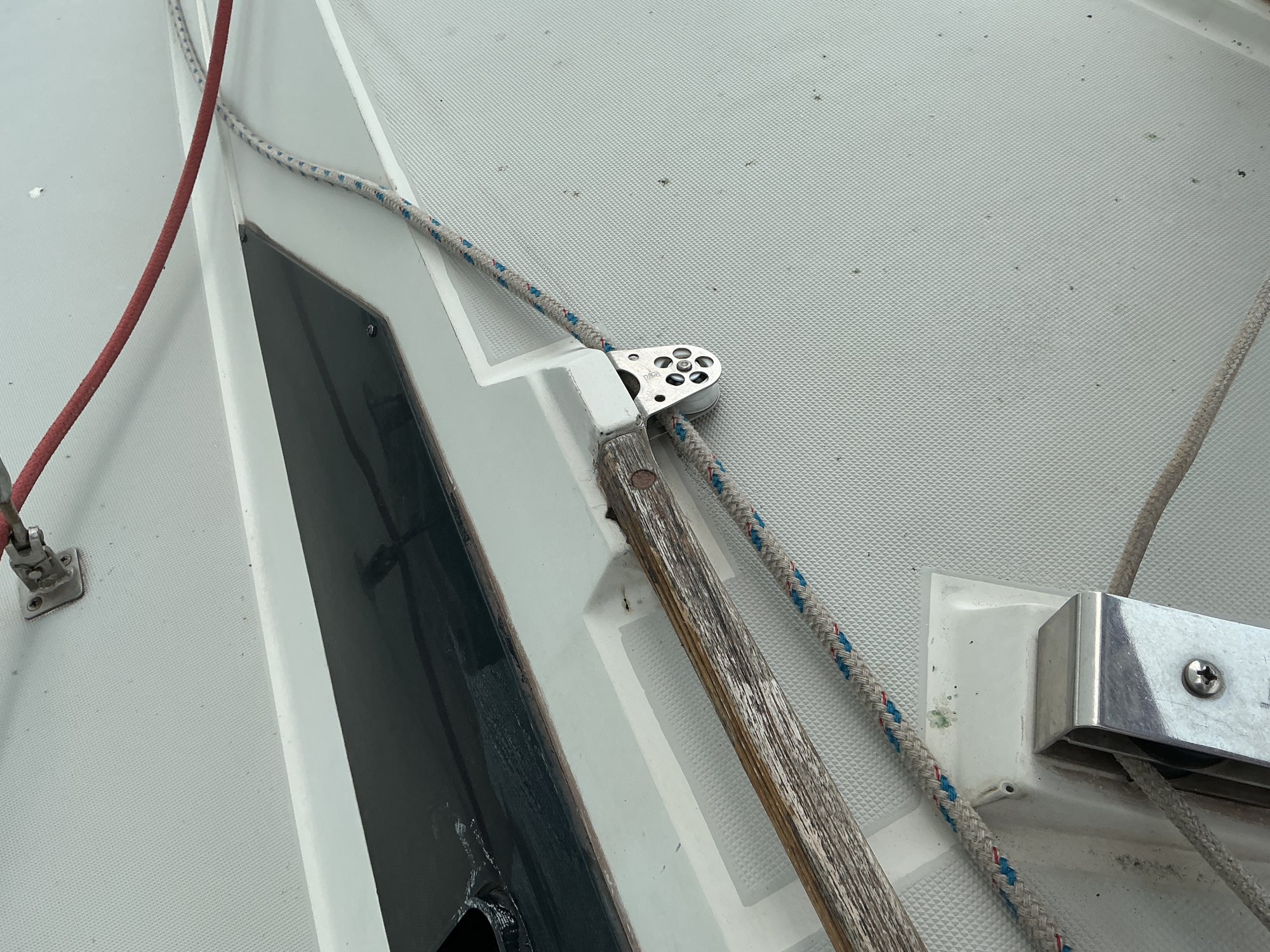

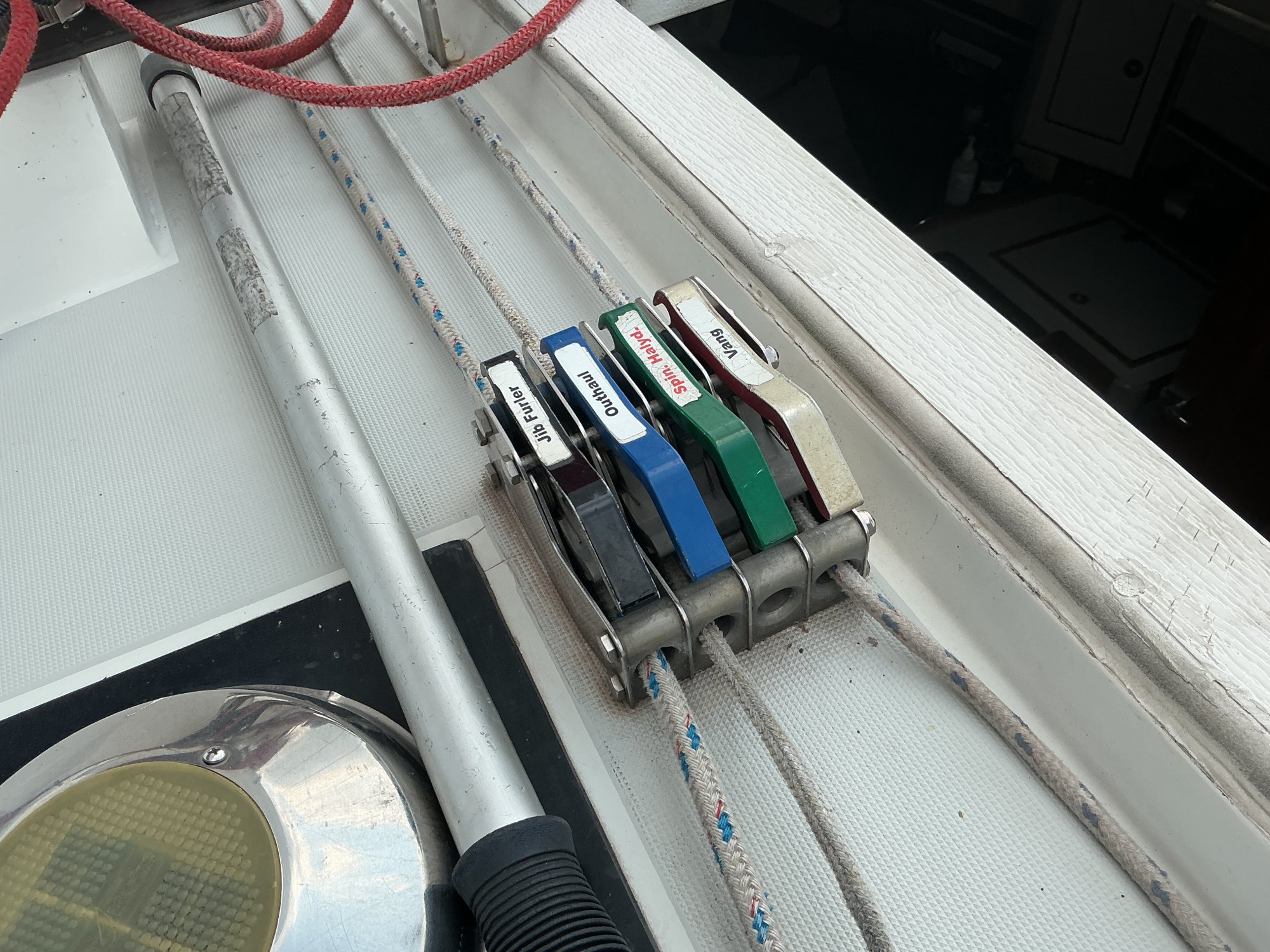

My O’Day 322 furling line was originally routed along the toe rail and was cleated off on the outboard deck near the helm. I meant leaning over to unclean or cleat the line. I did not like it.
then I realized I had an open rope clutch on my port side cabintop…one of 4 clutches I wasn’t using (was for 2nd reef line).
I routed the furling line to the rope clutch (required moving one of the stanchion blocks to the cabin top hand rail).
I love this set up…I can easily pull in the furling line from the cockpit, and I can use the clutch to stop the line from running out when I want reef the jib.
i love the set up.
greg
Likes: BarryL
24,599
Looks good Greg. Appears you don’t have much of a tripping hazard. That is one reason I still have the line running along the rail.
