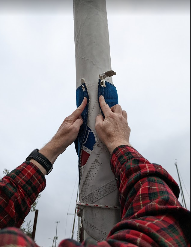

PO said he never used it as he took the sail down in the off-season and the boat out of the water. I'm not doing that, so thought I'd cover up the genoa with the provided cover and ... it doesn't seem to fit. It's a good 1/2" from closing around the highest point (above where the jib sheets are holding it closed) I can reach on tippy toes, so not even close.
Could it have been for another sail? This one's a 135%, at least according to its bag (looks about that). Am I doing it wrong, although I don't see how? There isn't like ... a way to force a furling sail to furl different (if the thickest point was at the bottom, it might at least fit most of it!), is there? :D I suspect it was just for a different sail but figured I'd ask to see if I'm missing something obvious.

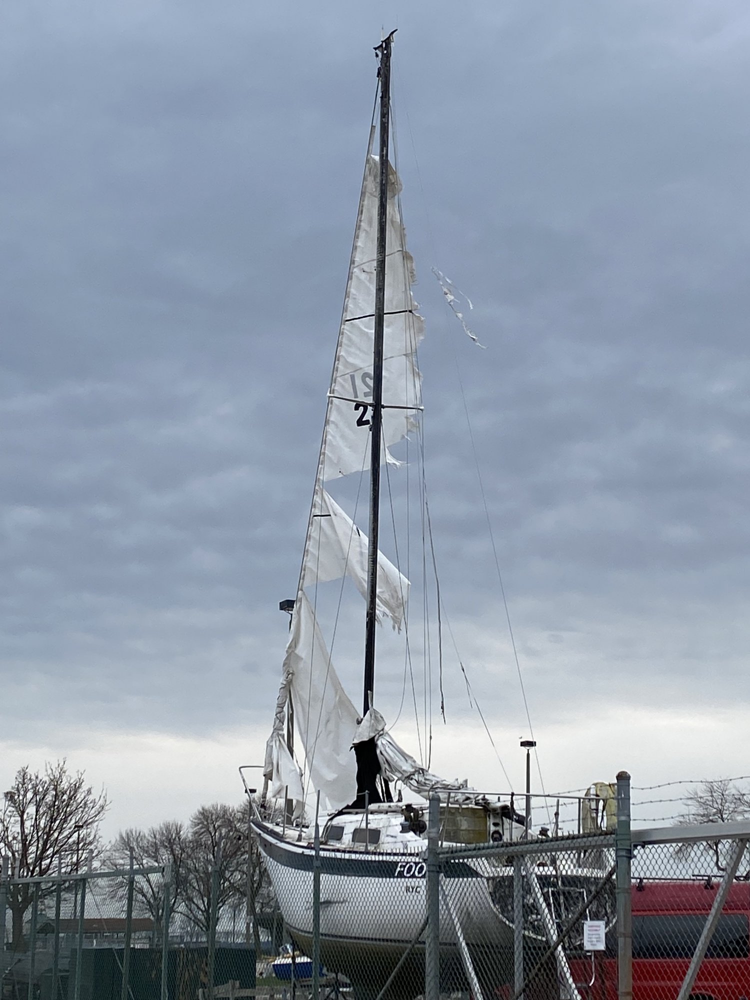

Winters here in the PacificNW can be very hard on sails. If the rain and ice don't break down the sail material the wind and sleet will work the sail off the furler and rip it to shreds. Taking your sail down in the winter and storing it in a dry space will give you a sail ready to go next spring. If you get a great winter weather window to go sailing, raising the sail and putting it away again are just good seamanship. The first winter gale that blows down the gorge will have you sitting quietly by a fire sipping a hot drink saying: Thank Goodness I dropped that sail.

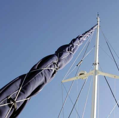

Greg here is what one looks like... by Rolly Tasker

Is this a slip on cover? You hoist the cover to the tope of the sail with a halyard? Zipper down the center line?
Yep, that's the one. It's just a wee bit too tight around the thickest part of the furl.
test rewinding the sail
Yeah, that was the first thing I did. I made sure it was a calm wind day and cinched it up. I think it was just made for another sail. Guess that's the "fun" of getting a box of parts from the PO. :)
Otherwise, why not just pull the sail down?
A local sailor here just wants to protect his sail all the time, so he pulls it up. It's a lot faster than taking the sail off the furler itself - when properly fitted it just glides up. I'm pretty sure it's more of a sun than a rain cover though.
His and mine look more like the gent illustrating here:

Holding it as tight as I can fairly high up. It would probably fit ... another 6ft higher. :p
Next time I unfurl it I'm going to check what it looks like at the luff; maybe there's something folded badly there but I'm inclined to think it's just not for this sail.

Maybe a stepladder to get above the thickest part of the wrap, does your cover have a wider section or just one continuous diameter?
23,270
Your image shows one end of the wrap.
  • How does it go up to the top of the sail?
  • Could it be upside down?
  • It may zip closed lower down and have more cloth in the middle where the sail bulge gets a bit more cloth.
  • It may be the wrong size , why the PO didn’t use it.
Continuous. I tried both sides, it's identical - was my first thought as well. I think even with some way to get above the thickest part I'd still run into trouble down here. The covers I've seen have way more slack, and a gap in the middle for the sheets to egress. This is definitely weird because it is in fact one continuous zipper. I guess that would work if you slack your sheets to run out the bottom but that doesn't feel particularly secure either.
Those holes are where a halyard would go, I assume. Your guess is as good as mine.
