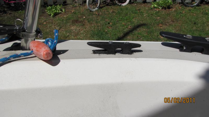

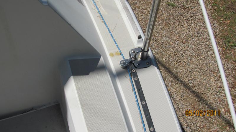

My 1986 O'Day 222 came through with the cleat mounted on the starboard side of the cabin close to the companionway bulkhead and I removed it shortly after I bought the boat new. Several years ago I bought a CDI FF-2 Roller Furler and didn't take into consideration where to mount the cleat for it. I only had enough line on the drum to mount it closer to the cabin so I mounted it on the combing between the bulkhead and the Gennie winch which was a big mistake. Every time I tacked, the Starboard sheet would get caught on the cleat as the Gennie was luffing and whipping the sheet from side to side.

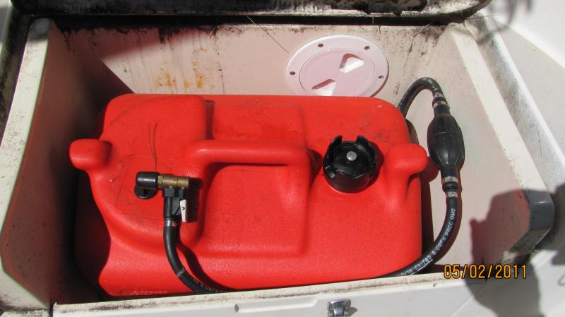

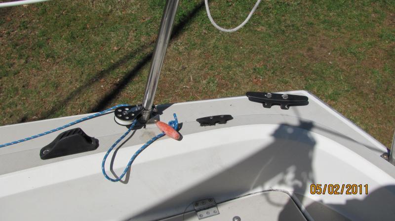

Last year I removed the cleat and bought a used nylon jam cleat and a 4" Beckson Deck Plate and mounted the cleat near my stern rail. I was able to access the the nuts & washers through the deck plate that I mounted inside the fuel locker on the Starboard side. The deck plate also allowed access to my stern cleat which I never had access to.
For me, being a single hand sailor, having the furler control line close to the helm where I can reach it easy, is the place it should have been from the start.
The jam cleat is supposed to be mounted on and angle to the line in order for it to snub off the line with one turn, but there just isn't enough space on my combing. I found that I could get the line to snub off if I take the wrap CCW instead of CW as my line enters a single sheave on part of my stern rail which provide the needed angle for it.
I had used a small stainless steel Herreshoff horn cleat for my furler drum control line and later decided I wanted something faster and easier so I decided on using the jam cleat and I really like it. You can tie the line off on it at the end of the day in the same way as tying to a conventional horn cleat. Actually, I usually use a 3/16"X 20" braid line to secure my furled Gennie when I put her up on the mooring.
These jam cleats are a bit pricey but fortunately I was able to buy both the cleat and the deck plate at a marine consignment shop in Newport RI for only $7.00.
Right now, I'm contemplating on either adding on to the control line or replacing it with a longer line. It works, but it's supposed to have so many wraps on the drum according to the furler manual and it doesn't. It really isn't something that I really need to worry about right now.
So if you single hand, you would want to mount the cleat where you can reach it easy from the helm well in back of a winch.
