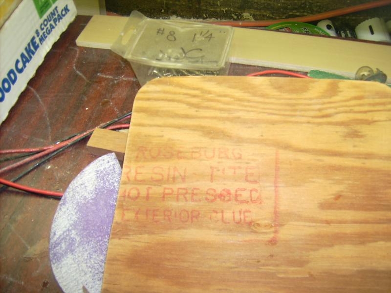

I just posted this to my boat's blog about an impressive discovery. This ought to end a few arguments-- at least I hope so-- and prove a point I have long tried to make: that sometimes 'good enough' really is good enough; though you have to let the yacht designers, yacht engineers and boatbuilders make that decision (and not the staff at Home Depot).
See if you can spot the funny fact in this photo--
Or read the full story--
http://dianaofburlington.blogspot.com/2012/03/argument-ender-and-joyous-surprise.html

I'm sorry. What does this actually prove?
1,085
To me, it proves that the appropriate material can be selected on sound engineering priciples rather than following some gospel that one reads on the internet, etc., etc.
Hunter, sometimes dissed on quality of build, elected NOT to use marine ply in this application (horrors!) and, lo and behold, the material is in perfect condition 35+ years hence.
For those in the know, often the only difference between 'Marine' and 'Exterior' grade plywood is the % of voids or spaces in the plys. The waterproof glue is exactly the same in both products. Exotic veneers are available on both types. So JC II's choice of ply for interior cabinetry works for me. I would probably buy Marine grade for building a hull however...

I posted this because of some halfhearted flak I was getting for not using 'marine plywood' in this restoration. People had claimed that I was using wood of a lesser grade than what it had been built with. I had stated to these people (some here and some in my boat's neighborhood) that it doesn't matter, that most boatbuilders decide on a formula of cost savings versus quality and usually come down on the cost savings side. And, still, we are all still sailing about in 30-plus-year-old boats that were not built strictly to ideal standards.
I was impressed that though the mantra of 'marine plywood only for boats' was conspicuously disregarded in this case, the 'inferior' grade lasted 37 years in conditions that, at least in theory, should have rendered it goopy wet glop in about half that time. My own ethic of treating all raw wood with epoxy if it is either out of sight or bonded to the hull will probably ensure another 35-odd years or more of life for this boat (tremble at the thought!).
