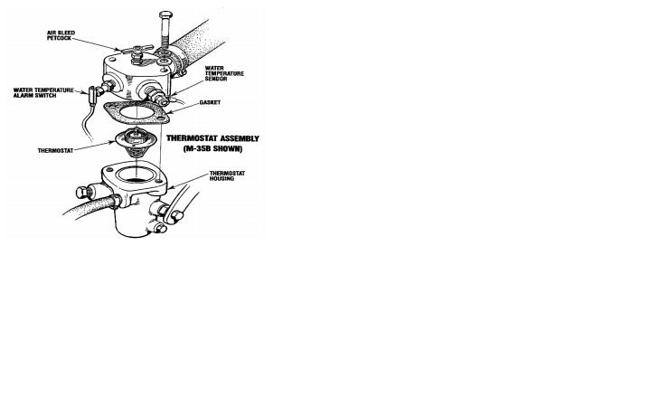

Check your connections
Most likely one is the connection on the thermostat on the top of the engine that is loose.
Dec 16, 2011
261
Catalina 310 Atlantic Highlands
I've heard that a replacement thermostat is difficult to find these days, but I haven't tried to look. A mechanic mentioned that to me.
Since my problem is the voltmeter on eng panel reason thermostat connection involved because hooked
up to electrical path to voltmeter? Thanks for your response.
