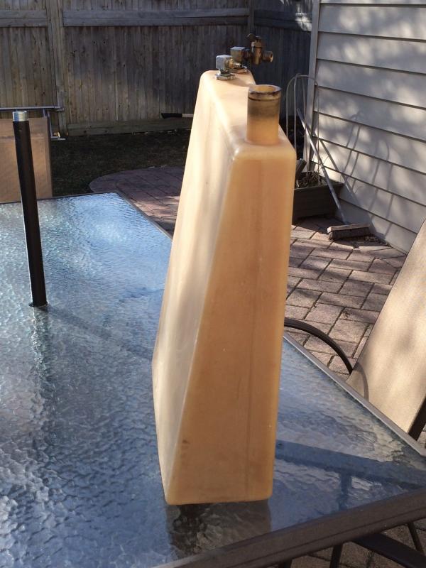

I'm pulling my fuel tank out this weekend for a transom repair (don't ask). It'll be out of the boat for a spell and I can measure it up. (1987 272LE)

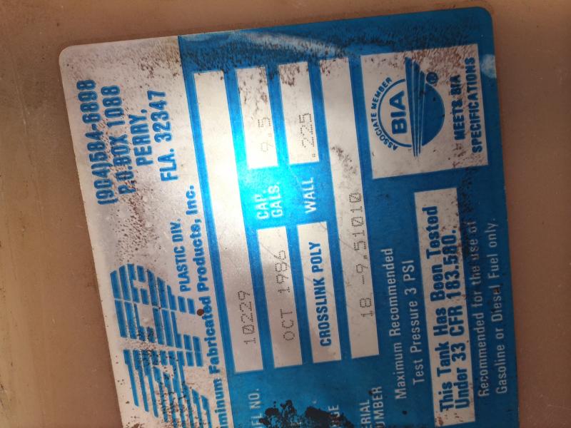

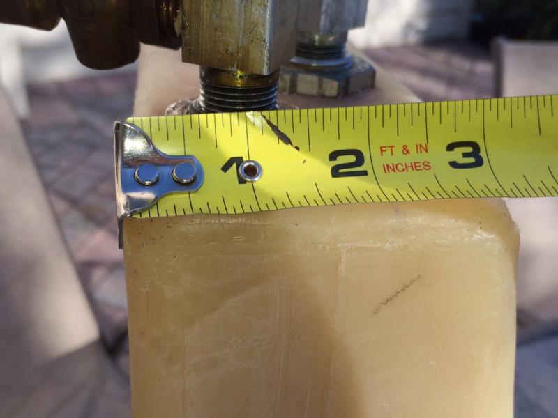

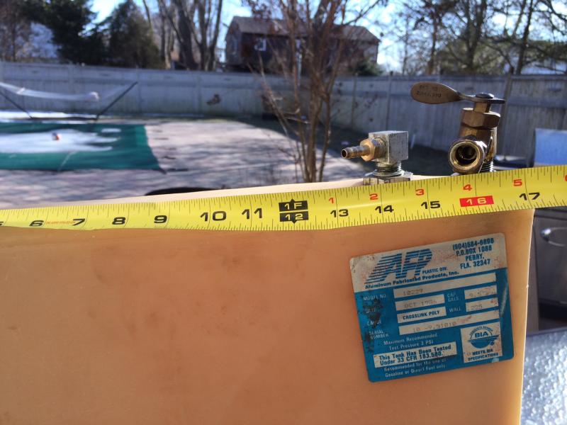

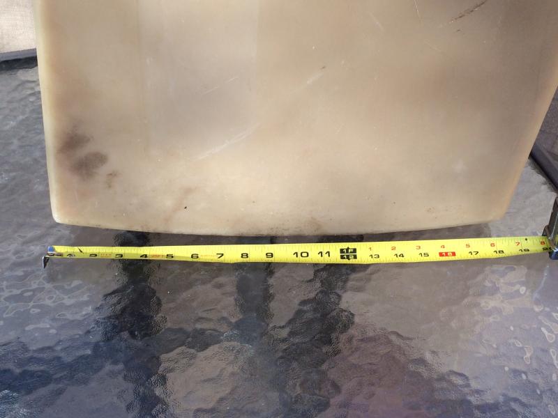

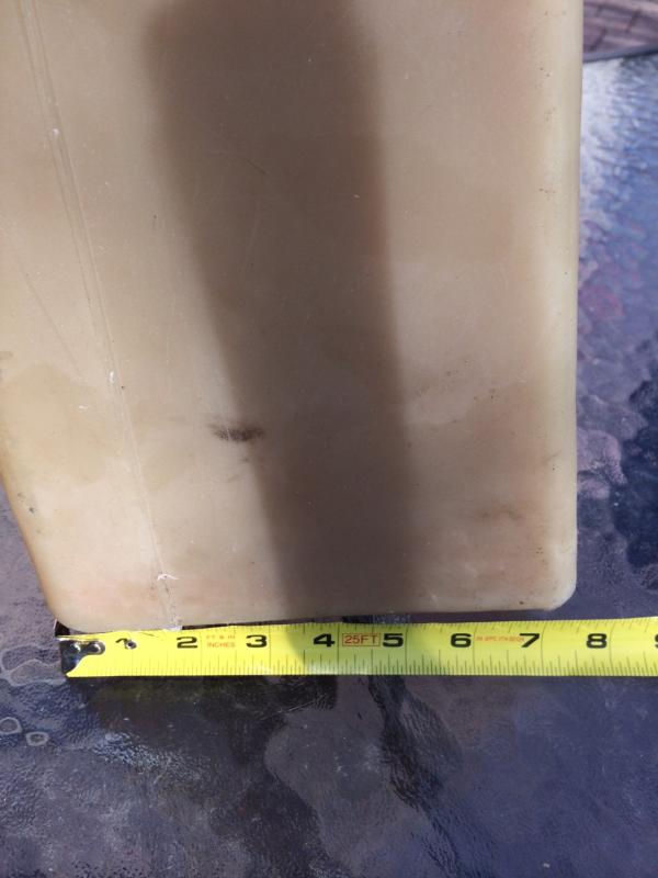

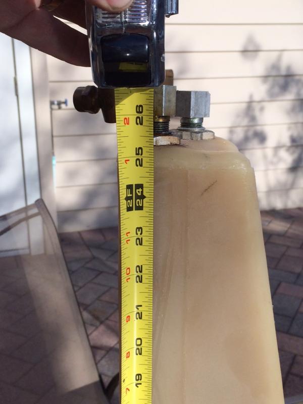

Here's a bunch of pics of the tank. A friend at my marina had one fabricated last year for a 272, I can get details from him if you want. I googled the manufacturer and I think they're out of business (or not on the internet..).
Let me know if you want me to track down how my friend got his tank.

Mickstr6, thank you so much for the pics and the measurements. It's a real help for me. I've been looking online for one but no luck. If you could ask your friend where he purchased his, it would be most helpful. I hate having to bug you, but these boats are so out of date that it's harder to find parts anywhere. Again, thanks for all your help. Hard Tack
Dec 3, 2013
16
Oday 272 Jefferson
Mickstr6, the pics printed out great. What I don't see is the overall length measurement on the tank top to bottom and the top side depth. I see that the bottom width/depth is 7" but it obviously narrows at the top. If you know or can get me these 2 measurements, that would be great. I will, in the meantime, get out there & see if I can get some measurements from inside the fuel tank area of the hull.

Sorry, was limited to 5 uploads. here's 2 more. I'll get the info on the replacement tank in the next few days.

Unless I'm reading your tank wrong, or my 272 manual incorrectly, there is a disparity in capacity of the tank. Maybe it's different from gas to diesel...? Mine is supposed to have a 9 gal capacity (Westerbeke 10-2 diesel inboard), and the plate on yours looks to say 5 gal. 1987 O'Day 272.
Did I see that right? Or is this a gas vs diesel problem?

Upon closer examination, it appears that the capacity shows 9.5 as capacity, not 5...
Sorry for misreading.

Just went out in the garage and verified, and it does say 9.5. Funny, all O'Day specs say 9 gallons. Anyhow, I called the fabricator that made my friends tank last year, and he did not keep the specs.
So, I'm not sure how I can help anymore, other than measuring up my tank more accurately in case you want some one local to make a tank for you based on my specs..
