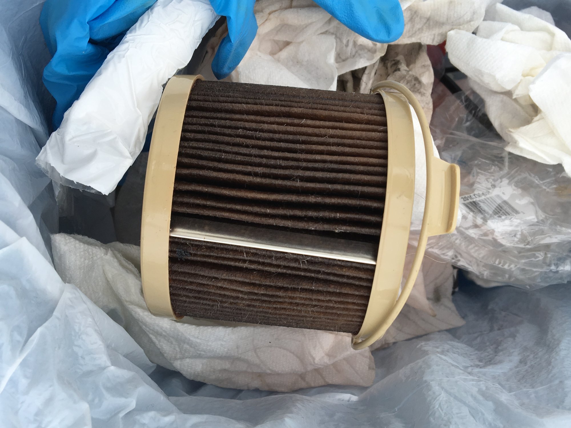

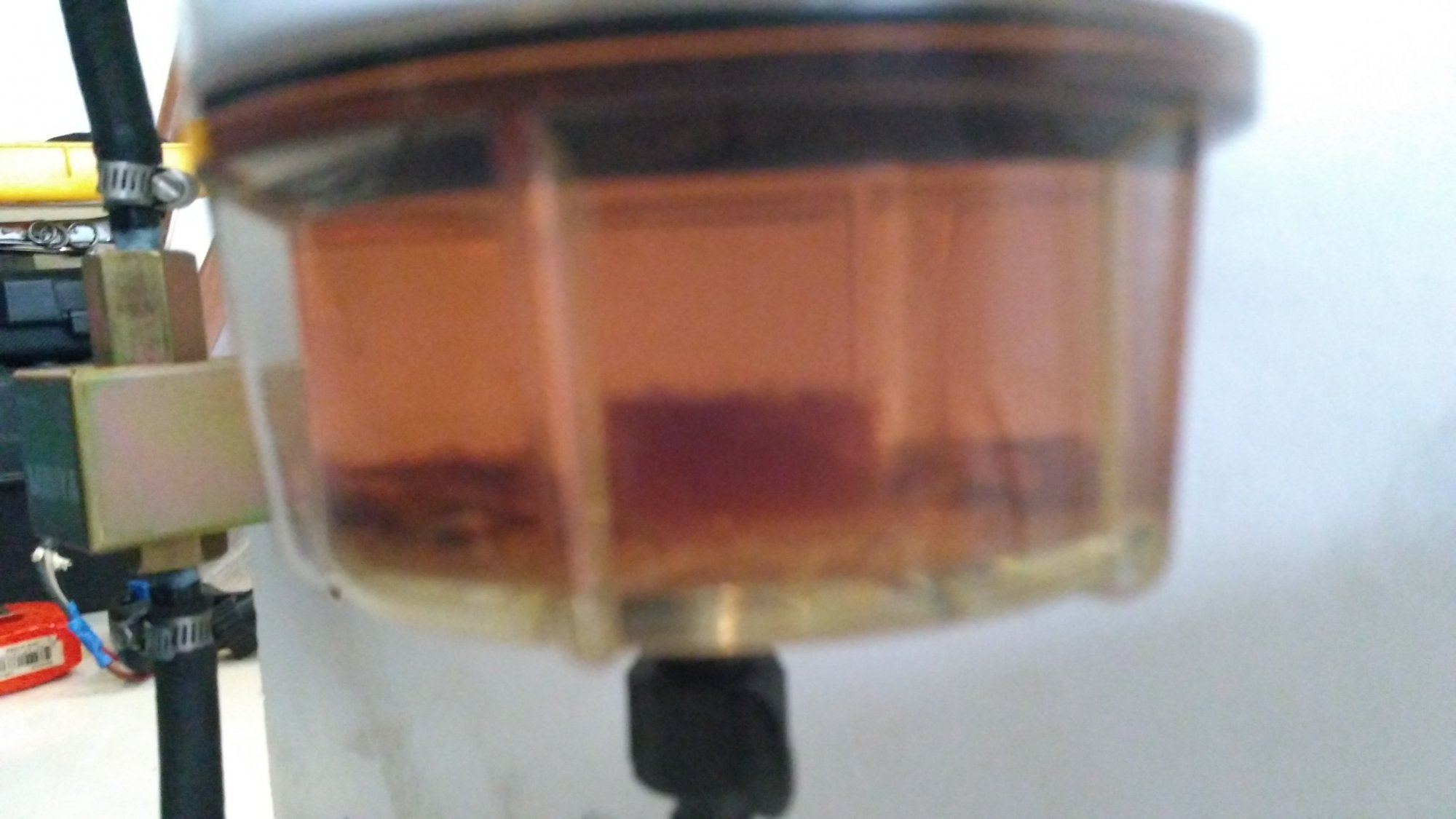

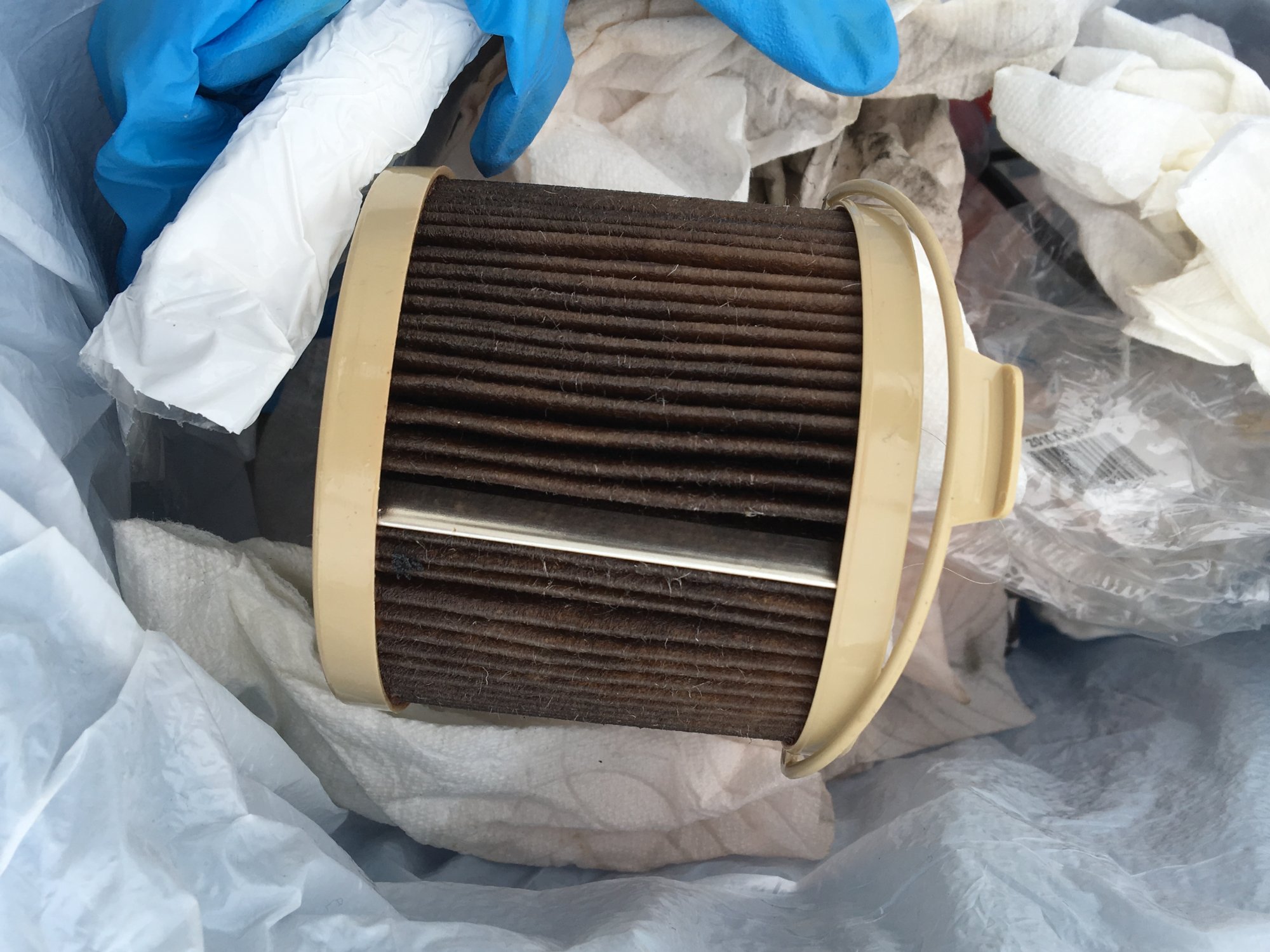

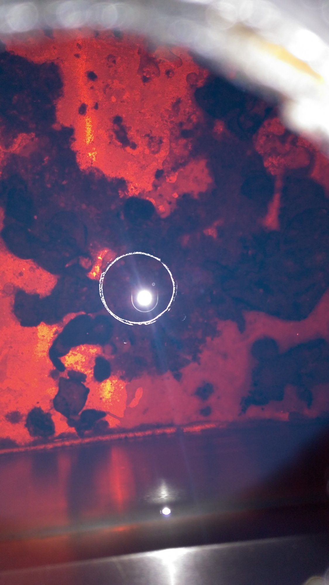

So. I made a fuel polisher and sucked out a lot of crud. In fact the sludge plugged up my 3/8 pickup line. I got a lot out but now where near all as I could only access through the level indicator hole. I had the engine die on me about a month into the season again. Easy to get it going , but messy and annoying. I once again ran the polisher as the crud had moved again to the pickup tube. I finally got some Biobor and adding a shock treatment. I also use Diesel clean as an additive. I think that killed off the bug from growing, however you're still stuck with the crud. It doesn't break down and while my engine never quit it did once in a while start to loose power. Next additive was Diesel clean tank and fuel system cleaner. This is specifically made to break down the crap into microscopic particles. I 've never had anything in the Racor filter until I added this stuff. I had to clean out the seperator twice and about to change the filter as well. So far after 50 hrs not even a hickup or burp from the engine. Pics attatched show the back crap on the bottom of the tank and the other was within 5 minutes of the fuel polisher running.
