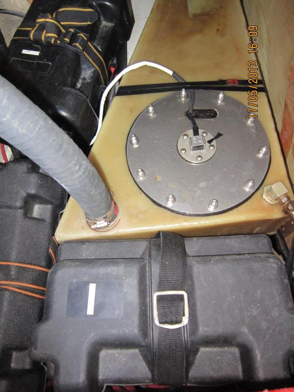

No separator in the tank itself. And no baffles either. I did install a Seabuilt inspection plate on my original poly tank. And added a WEMA fuel gauge sender. Seabuilt does come with the gaskets (Unsure but I think it is butyl). I followed installation procedure recommended by Seabuiltv and have not had any leaking problems. http://www.seabuilt.com/compatibility.php

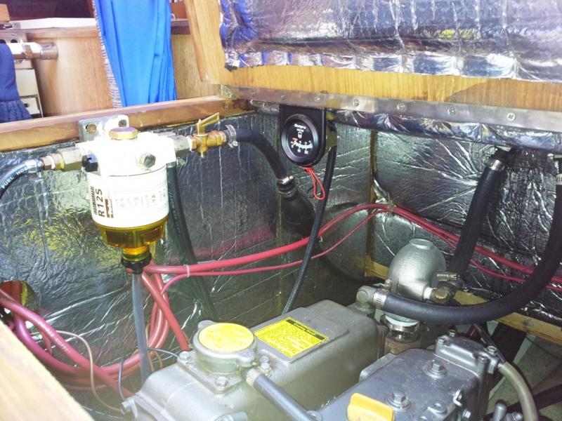

I relocated my Racor to the front of the engine compartment so I can keep a close watch on any water starting to accumulate and can drain it away. Maybe you still have the old Perko brass filter/separator way back in the back of the engine compartment? That was too hard to get to, hence the relocation. Same for the raw water strainer. Its up front now too.
Here is the link I posted earlier this year describing how I installed the cleanout port in my tank. It was pretty easy and the dual Buna gasket that comes with the kit doesn't leak.
