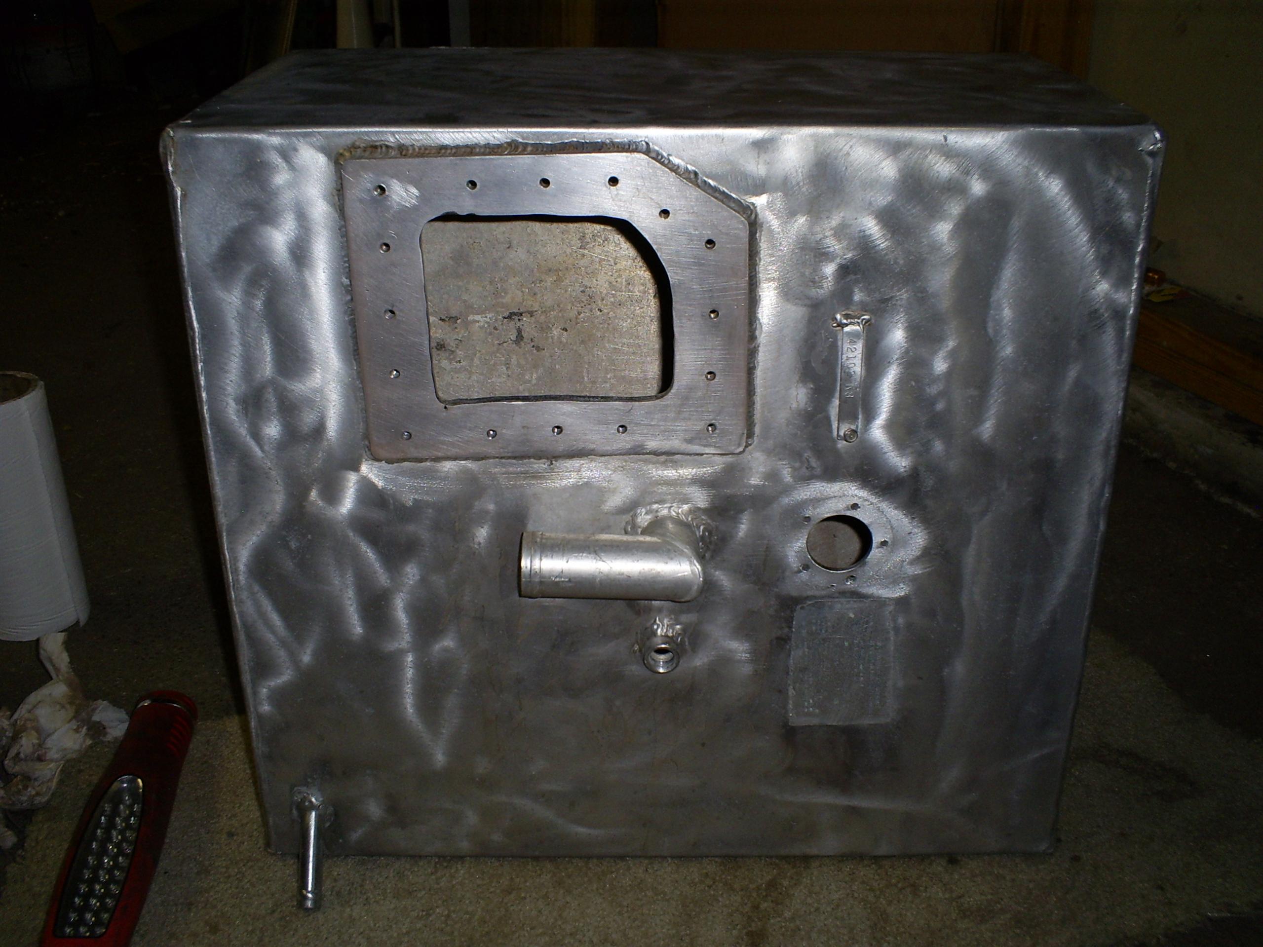

My fuel tank was designed to sit with the bottom flat and touching the boat inside the whatever you call the hatch by the transom.(I guess I would call it the trunk)lol Water has made corrosion pits on the bottom of the tank.
I made an access panel and had it TIGGed to the top of my fuel tank. I think it is 15 gal. I cleaned it out with acetone and brake parts cleaner(I love that stuff). Spic n span. I also had a leak tigged that the PO had circled on the bottom.
I bought a gal. of fiberglass resin today. For future use. I have only fiberglassed one thing before so I am not experienced with it yet.
I want to coat the bottom of the tank on the outside, in some epoxy like coating or urethane. Will fiberglass resin do well in this application?
I took my rebuilt engine to my boat lat weekend. Sunday I am going to drop it into the compartment connect everything and try to start it. I need my fuel tank on Sunday. So whatever I do I want to be able to accomplish it Saturday and be ready to take it and install it and use it on Sunday.

Rad- unfortunately there is no west marine near where I live in San Antonio. I need to try to fix it today. Also they will be closed tomorrow when I arrive in the town where my boat is. Plus I have a gal of fiberglass waiting on me downstairs.
Frank - Could you give me some details about how you glassed the leak? Did you put a small patch (less than 3"), did you use any firberglass cloth weave, or did you just use the resin?
I think the same thing happened to my tank that happened to yours; where the tank rubber and water corroded simultaneously a hole developed.
I want to coat the whole bottom from the outside, then build stand-off-feet so the rubbing doesn't happen again. I do not want to put anything inside the tank. There are some questionable areas from water corrosion so I want to fix it right. There is alot so I can't have my welder cover the whole bottom, I would just cut another aluminium sheet and cover and weld to the bottom if fiberglassing wasn't an option.

Thanks for the info on the fiberglass. I am not confident enough with fiberglass yet to bank on it working for me. I used a punch to dent the tank where any suspicious looking spots were and then skim coated it with JB Weld. I will be able to powder coat right over top of JB Weld if I decide to do that later.
I need to practice with the fiberglass before I use it on anything critical.
