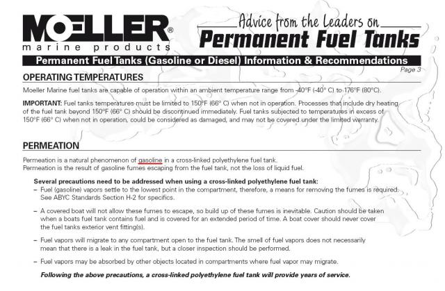

More on Vapour Permeation ........................
I can certainly see why you used aluminum in this application - dimensional stability, intricate shape, and $COST$.
I was quite interested in the permeation characteristic as I have never had any diesel smell from my 10 year old poly tank in our 1999 H310. Mind you, our waters are pretty cool here (cooler fuel tank resting on a cold hull) which may account for the cooler tank and lack of permeation. This may not be the case down south for permeation.
Took a look on the Moeller web site and found the following reference to gasoline vapour permeation only but no reference to diesel fuel. Hopefully the longer chain molecules in diesel reduces permeation to a minimum. Always interesting to know.
Now that I've convinced myself of that ..... I can get to sleep tonight.
