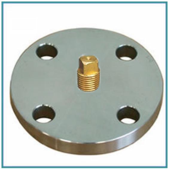

The only problem with that is that you don't pick up the crud off the bottom of the tank, only the junk that's level with the fuel intake which is several inches off the bottom of the tank. You will get a steady supply of crud as the fuel sloshes around when the boat heels. Also, you don't want an internal screen in the tank as they're a real bear to clean when they plug, and they always plug exactly when you DON'T want them to plug :doh:.
What I did was to machine a 3/8" SS plate into a miniature blind flange as very, very, roughly shown below. The holes, of course, are much smaller. One could just as easy use 1/2" HDPE Starboard. The flange is about 2-1/2" dia. and has a 3/8" brass pipe plug lightly snugged in the middle. The flange is screwed to the top of the tank using Permatex #2 as a sealant.
Each time you want to vacuum out the tank, unscrew the brass plug and insert the vacuum pump tube to the bottom of the tank.

Ralph: you have a good point; the screen has to go; i think your application of a drain plug could also work on the side of the tank, as starboard locker gives access to the tank side. not much clearance between top of tank and cockpit floor to drill a hole.
thank you for sharing your handiwork.
