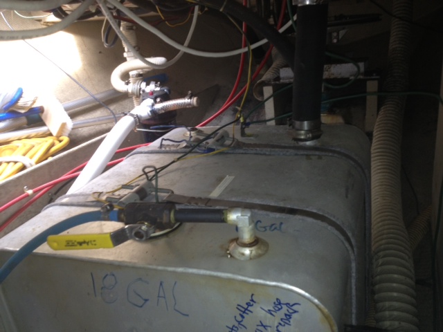

I am trying to avoid removing the bulkhead, which is tabbed in place, to get my tank out. I am thinking, drain it, rinse it with some soap and water, then cut it in half with my 18V sawzall. Half a tank (14.5 x 18.5 x 20) should fit out the starboard locker nicely. All hazmat will be collected for later proper disposal.

on the 9.2 A the tank is behind the engine and in front of the hot water heater.... the locker door/lid opening is only 13" wide..there is no way to get it out from the rear because of the steering quadrant and hot water heater ...and no way in the front because of the engine so that leaves you with 1. cutting the tank up 2. removing the engine 3. removing the hot water heater and steering quadrant....i took mine out through where the engine is mounted because i was replacing that any way......

So basically I would have to remove the bulkhead that is the wall between the quarter berth and under the cockpit. It is tabbed its whole length at the base. I would also have to remove the battery charger and cut tabbing to the bulkhead behind the engine it is also connected to.

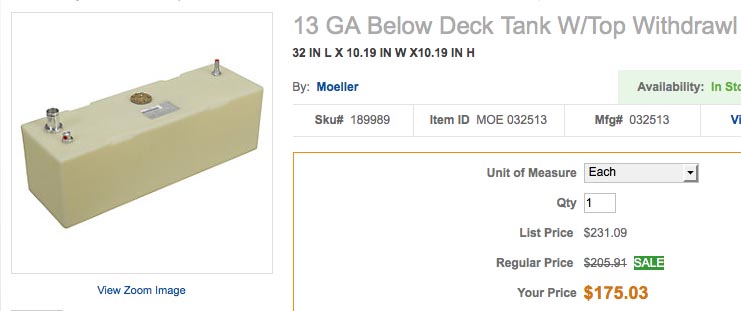

Now that all your purchasing is done: Did you see this 13 gallon Moeller unit? It's got the fuel inlet at one corner, although I've not measured to see if there's 30 inches of room either forward of that inlet. Probably not.

Probably not. The good thing about the tank I picked is that it should fit into the existing mount without major trouble. I guess I will find out! The flexible hose should work well. The normal hose would have done okay, but Moeller switched from an aluminum nipple to a molded one and well I felt I could heat the hose to get it in place I was worried that there would be a constant strain in it that could cause a failure.
