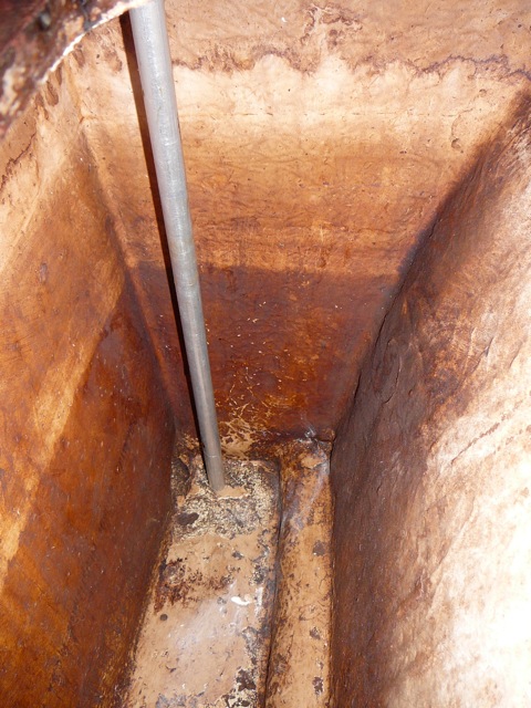

Having now removed the fuel tank tops and cleaned up all the threads and the fuel varnish from the bottom of the after part of both tanks I wondered how the fuel transfers from the port to starboard side of the tank.I expected to see a connecting passage between the after parts of the tanks so that all the fuel can be used whatever the sea state but the only interconnecting passage was forward of the centreboard trunk.Does anybody know if this is correct as it looks as if you will never be able to suck up all the fuel with only one suction pipe on the starboard side unless I make a linked suction pipe from each side which means I just have to tap another hole into the port tank and suck fuel from both at once.

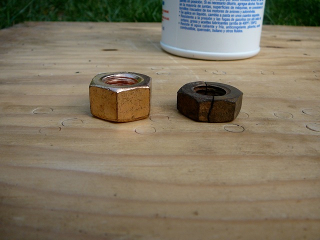

Here are a couple of photos that might be of interest. First is the split keel bolt nut that I found in the tank. The replacement is next to it. There was a light seepage of diesel from the keel-hull joint in the region of this keel bolt in the past. It occurred over the winter while the boat was sitting on its keel. I guessed at the time that the weight compressed the keel-hull joint enough to allow a little seepage. After seeing the missing nut I realized that this may have contributed as well. In any event, there is no longer any seepage.
The second picture shows the port aft tank interior, looking aft. The tube is a pickup tube I threaded into the fiberglass floor that serves as a tube for pumping out the last bit of fuel (and any water) that might be in the tank. It is cut at an angle, and extends to the very bottom. It also serves as a dipstick hole for checking fuel.
To the left of the tube, in the corner, you can just make out a 1/4 circle cutout (about 1+ inch radius) in the center wall of the tank. This lets fuel flow between the two tanks, albeit not to rapidly.

Thanks very much for your information, and pictures, I would never have seen the small hole linking the after part of the tanks without your pointing it out. I have taken some pictures of mine, not terribly clear, and you may be able to see a slightly rough portion where the hole on your tanks are. I would think that this may have got filled in when the boat was built but there may be a very small hole or crack where the hole should be. I now feel happy to poke around in that area and open up anything I find. Then I have the enormous job of cleaning the tanks as best I can and I'm still inclined to epoxy the insides and the tank lids before I reassemble all the parts again. This will probably be when the weather gets warmer. Thanks again for solving my problems, my only worry now is whether the keel bolts are sound, but without dropping the keel I'm not sure how I would inspect them. Any ideas? Thanks again
