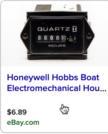

Fuel gauges are mere indicators that there is some fuel in the tank. No sailor worth his salt would trust a fuel gauge. As mentioned by @Davidasailor26 and @Belzoni, you need to keep a log of your fuel consumption. It is a very easy task. A Hobbes meter (or clock tracking engine run time) is a handy tool to help you with the log. They are cheap and easy to wire.
Here is one from a quick online search.
Nothing fancy. Hook it onto the red wire to your engine start system to provide power to the clock when you turn on the engine.
