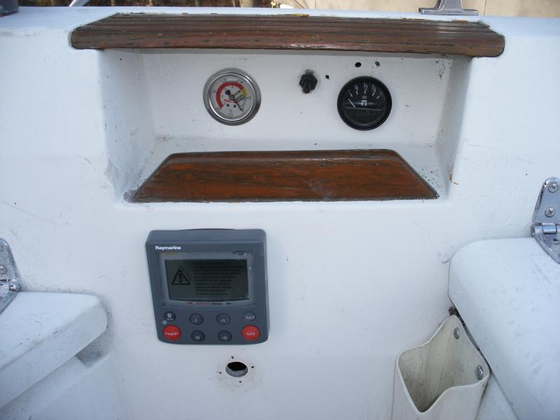

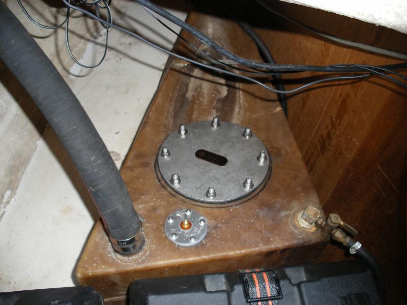

I put a Tempo sender in my fuel tank and a gage in my cockpit over five years ago and have been very satisfied with the performance of them. Here's a pic of the tank top-the small silver thing by the fill hose is the sender unit (the other big thing is a Seabuilt clean-out port).
The second pic is of the fuel gage in a cockpit cubby, next to the filter vacuum gage. The switch between them activates the gage when checking so it doesn't draw current all the time while sailing.
Hope these are informative for you...

Thanks Dan. Very informative. I am motivated to git er done! Sandy
