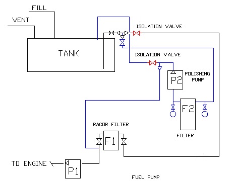

My system is not nearly as nice looking as Maine Sail's but it has served me well.
P2 will be a Walbro FRA-1-1 Fuel Pump Walbro FRA-Series Fuel Pumps are the perfect choice where low cost and good durability are important. The FRA-1 fuel pump supersedes the Walbro 2401-1 fuel pump, which has been discontinued. The FRA-1 is one of two pumps that supersede the Walbro 2108-1 fuel pump. (The FRD-1 is also an acceptable replacement for the Walbro 2108-1 fuel pump.)
F2 will be a Plastic (polypropylene) 10" home water filtration housing with a standard 5 micron water filter (details below)
I will have a vacuum gauge between the filter and pump to keep an eye on the filter as if collects junk. The higher the vacuum the more junk has been collected.
There is also two valves (shown in red on the diagram) that can direct the clean fuel to the engine instead of the tank in case the main (F1) filter gets clogged up.
Filter Details:
This is a water removing filter designed for use in a whole house water filter that uses a 10" filter cartridge.(available on eBay or most home improvement stores) The inner filter is a standard 5 micron polypropylene filter cartridge and is replaceable. The outer layer is a filter that incorporates a Super-absorbent Polymer that will absorb up to 60 times its volume in water and the impurities carried by water. This filter will not absorb vegetable oils, animal fats or petroleum oils. After the oil exits the inner filter, it is directed through the Super-absorbent Polymer layer which absorbs and holds water but allows the oil to pass right through.
(I actually ended up placing a Raycore filter between F2 and P2 also but it really is only there for redundancy not necessity)
The valves (shown in red on the diagram) change the flow of clean pressurized fuel from going back to the tank and instead into the engine, by-passing the main Racor in case it clogs up or the main fuel pump goes out.
The details can be seen here: http://www.winddragon.net/projects/fuel-polishing.html
