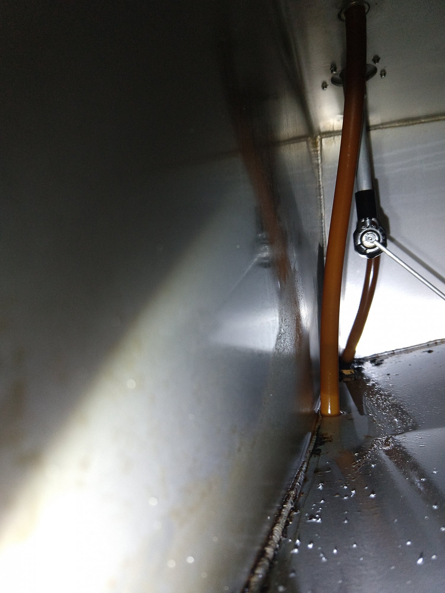

This is how the Catalina factory set mine. Not only at the bottom but under pressure so it was pushing down and no real bologne slice.
My advice is to drain the tank and get a borscope to check how it's set through the sender unit whole.
