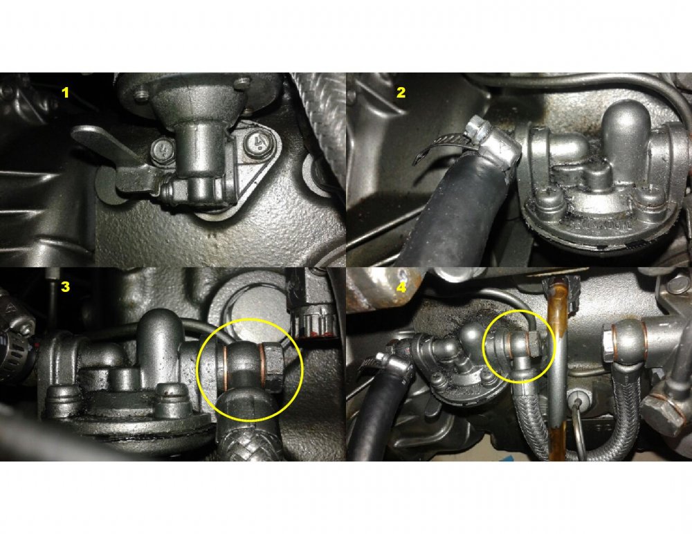

Yanmar 3Gm30F. Replaced both Racor filter and Yanmar small filter (# 104500-55710) late last year and have had a leak since. Looked like it was coming from the Yanmar fuel bowl, and I had pads under the engine to collect the spilled fuel).

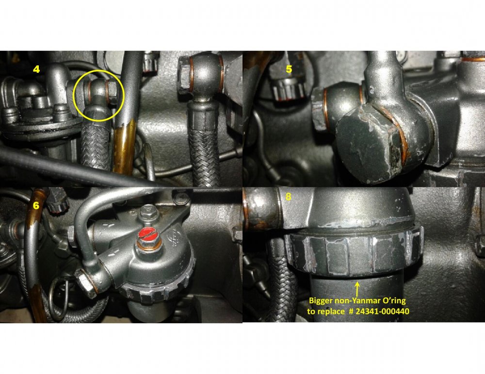

So this week-end, although I had already done so when changing the filter, I replaced the O'Ring with another original (# 24341 000440). Still leaking so I got another O'ring, this time not a Yanmar, but same diameter and slightly a little thicker. Case closed or so I thought. No more leak at fuel filter !

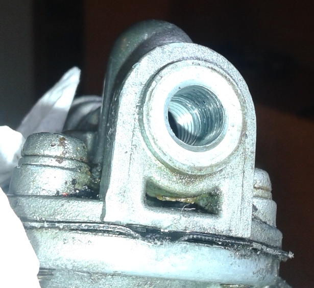

But enough of a leak at both the fuel lift pump outlet (circled on pics) and at fuel line inlet into fuel bowl that I could now see the droplets falling. So, I installed new banjo washers at both ends of meshed fuel line. Solved the leak at fuel bowl inlet end of line, but still leaking at fuel lift pump outlet.
And the problem seems to be that I cannot tighten the line tight enough. And putting more torque lets it slip rather than sitting it tight enough. I can replace the washers again but wonder about the impossibility to tighten it correctly ?
So my questions are twofold: 1) Could the threads in the lift pump have been damaged by my torquing it too much, and 2) If that is the case, can a Helicoil be used to repair the threaded area or do I need to buy a new lift pump (outch that will probably hurt $$$$)
Inspection with a paper towel and bare hand show all areas on pics to be dry as a bone except the fuel line connection at the lift pump, in spite of the new banjo washers.
