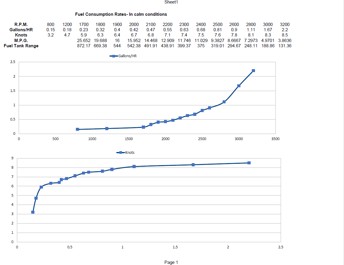

This is a spreadsheet from a C42 I found on a forum somewhere and thought it revealing. This guy did very careful measurements of fuel, miles traveled and speed over many years. His process was after each fill-up, he would pick a motoring rpm for that tank and always motor at that speed and take recordings of distance, average speed etc. He is much more methodical than I am, so I have just used the principals he found. I typically motor at 1900-rpm at 5.4-kts with my M25XP and get a safe 200 miles with a good reserve from the 17-gal tank on my C30.

I've read maybe hundreds of these fuel gph posts over the years. Many of them "promote" checking gph at different rpms. I think we all can understand that an ICE always uses less fuel at slower rpms. I believe, however, that it is a meaningless fact when that engine is used in a boat. Why? Because unless you ONLY motor at close to idle speed all the time (for whatever reason) then whenever you are using your engine you ARE going to be at a throttle range of beyond 50% to 80% of WOT which is where the average fuel consumption occurs. I have been observing boats for 35 years. Rarely do I see them merely "idling around" when out of their harbors. I motored out of the Oakland Estuary for 30 years and rarely saw dawdlers. :) I don't see any here in the Gulf or San Juan Islands either. Point being: doesn't matter about the reality of less fuel used at lower revs 'cuz that's not how we operate our boats.
