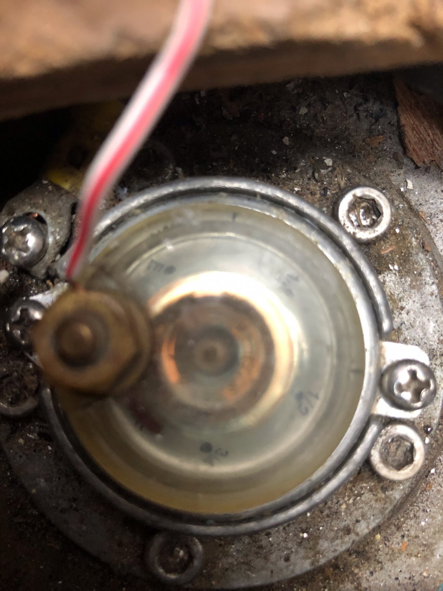

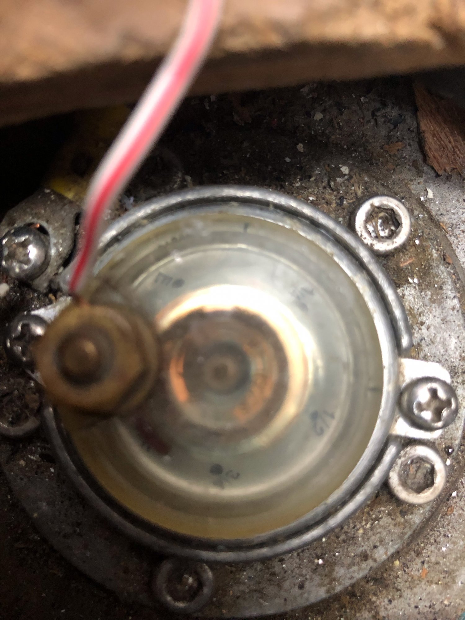

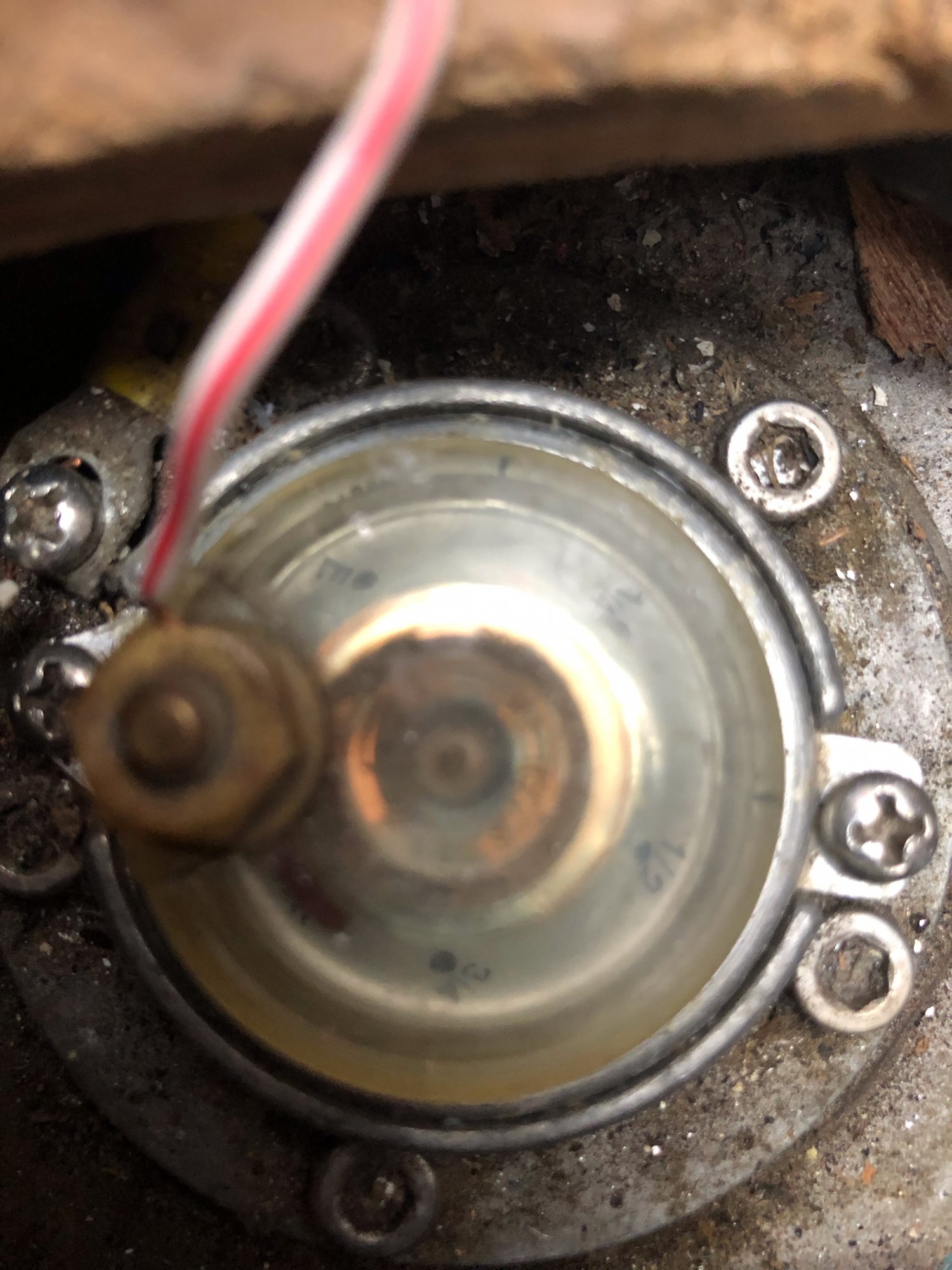

I don’t know your boat, but I found one of these on the fuel tank of my 1988 O’Day 322…
it has a visible gauge (very hard to read on my boat), but I learned it would also drive a standard fuel gauge…
Something like this..
So, you might want to inspect the top of the tank for something similar.

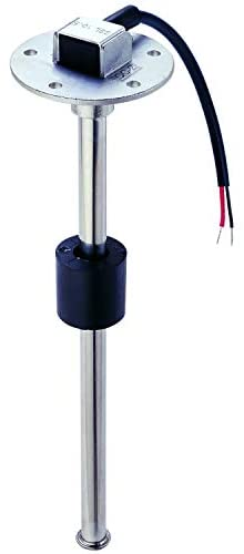

This is what I use as sending unit. The display is a standard 240 ohms display. The wiring is simple. You will have to cut a 2" hole on the top of the tank and screw the sender on with gasket. Your fuel tank may not be linear so 1/2 tank display may not correspond to 1/2 tank fuel. But you can take notes how many gallons takes to fill up from its current display.
Available on Amazon $70.00
