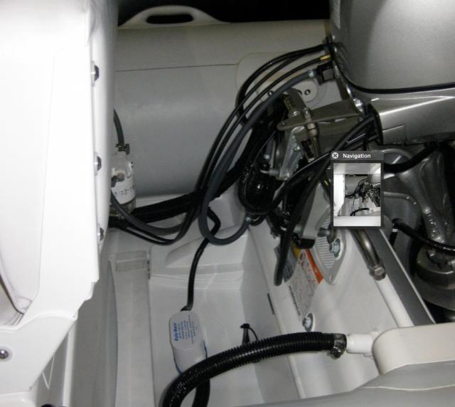

Here's a picture I took at a boat show of a Walker Bay RIB with an external filter. You can see it screwed to the seat. It's before the bulb. I think the engine's a Honda 15. I did something similar on my RIB.
I would guess this can help a lot where there's ethanol in the fuel. Ethanol tends to separate out the water. The filter would trap it.
I've also heard that you should cover up the clear part of the filter bowl to keep UV from hurting the gasoline. Not sure if that's true but it just takes a piece of duct tape..
