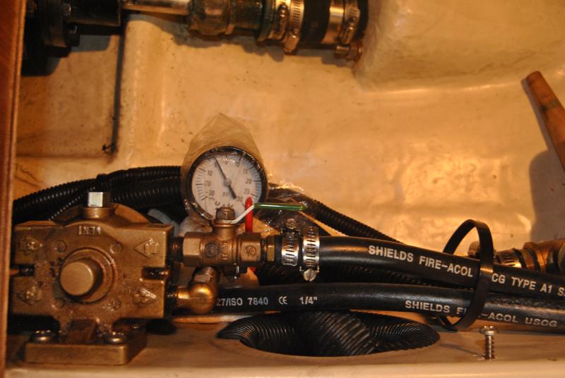

I have a question. I am getting ready to replace the fuel filters on my Yanmar 2GM20F diesel engine. The Yanmar manual states to close the fuel cock, except I can't seem to find it. Does anyone know where it is? The picture is not very helpful. The Seloc manual doesn't say anything about closing the fuel cock when replacing the fuel filter. I have 2 filters the primary is a Racor & the secondary on the engine. Any help would be greatly appreciated.

On my hunter 33, the fuel cock is directly on top of the fuel tank where the fuel outlet is. On my boat it is not visible, but if you put your hand there, you can feel it. It's very small - not like any of the thru-hull stopcocks.

...................... a fuel shut off valve. I installed a ball valve before the primary filter which gets used repeatedly for filter changes.

Same here on my 29.5. couldn't easily get to my fuel shut off so I installed one near the primary filter.

THank you everyone. Found the fuel cock today, it was in a hatch inside the port locker in the cockpit.Now tackling the filters. The Racor 110a is not a water seperator. Has anyone got any recommendations on changing it?

Done this 2x/season on my 1999 310 since new. The shutoff is in under a panel in the port aft cockpit locker. Sometimes its hard to get enough torque on the racor filter to take it apart; it's held on with two sheet metal screws to the fiberglass engine bearers and the screws may eventually tear through. Use a ratchet wrench or small oil filter wrench and keep your free hand on the filter housing to counter the torque trying to rip it off the bearer. One size will enable you to undo the drain plug and drain any water & crap. If what comes out is clean, no need to prematurely change the filter. If contaminated liquid or particles come out, time to change filter, even if its just a few hours use old. Don't forget the new gasket that comes with the filter. It goes in the top cover of the filter holder (remove the old one first). Always change both the engine and racor fuel filters together. Bleeding is the tough part of the job - many cycles of the lever on the lift pump required. Sometimes you can get away without bleeding all the way to the injectors and just need to get air and bubbles out of the engine mounted filter. Otherwise you need to loosen the injector bleed screw and get air out there too. Be sure to run engine for at least 5 minutes at the slip. A bubble in the system can take that long to find its way to the injector and stop the engine. After 5 minutes at 1200 rpm, you should be fine.
