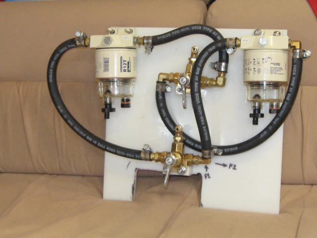

I would be willing to bet that the Perko unit you're referring to is merely a water seperator, not a filter at all (unless there's a cartridge inside). Any of Steve's Racor model recommendations would be a far better choice than having the Perko remain in place.

Steve, I had a look at your setup, nice idea. I'm curious about the twin sets of control valves. Either one of them could be eliminated with a T connector instead. Did you have a specific reason for using two sets of valves?
