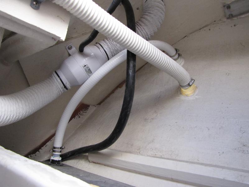

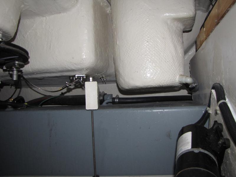

Pictures of fuel vent line.
paulj :troll:
Paul, I have said it before and will say it again - you have the best collection of photos for the 310 - you could illustrate your own manual on these boats. Not sure how you get some of these shots even? Do you have a library, or just easy access to get to your boat and take photos when needed?
