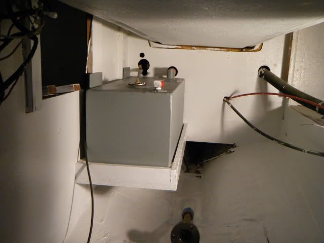

I've been having trouble fouling the carburetor on my outboard... so last night I removed my internal tank and gave it a very thorough cleaning.
Since it was out... I figured it was a good time to assess the merits of its former location in my boat. I want to reposition it (just a little) so that it will occupy space that is less desirable for storage. At present it resides just inside the largest of my cockpit lockers. So essentially it is a fuel locker only. Premium space is being wasted and on a small boat... :naughty:
But there is room under the cockpit sole so.... that seems like a better place and it will also balance out the weight a bit.
By moving the tank I'll need to run a longer fuel fill hose. I don't want to relocate my deck plate (seems like unnecessary fiberglass/gel coat work).

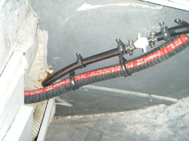

I drew a cartoon what what I'm thinking I'd like to do.
If you know of any reasons why this is a bad idea, please share... working with gasoline in closed spaces ... I really don't want to overlook anything.
