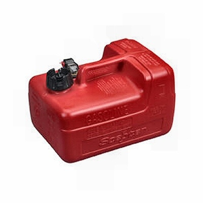

Jun 1, 2004
1,182
Catalina 22 P. P. Y. C.
Fuel Tanks
Here's a picture of the tanks that work in the locker
Sep 19, 2010
525
Catalina 22 home
Yes, I have two of those in my '86 fuel locker and they fit fine. Even with a 9.9 engine I could motor all weekend with the fuel in those two tanks.
