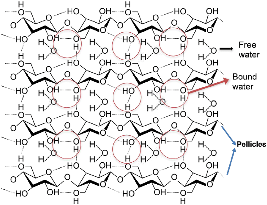

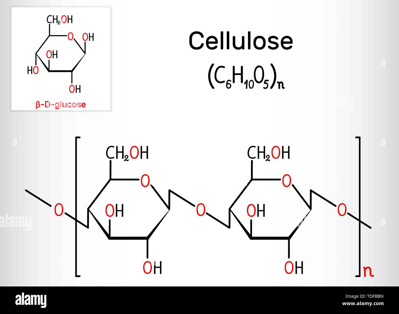

I'm not sure "bound water" is relevant. Wood is a cellulose (a sugar polymer). It can be represented like this
where "n" means each unit is bound to another identical unit as the chain grows longer and longer. Water can be "split" across the OH and O groups in the ring... by a mechanism called "hydrogen bonding". something like this... (see red circles for a "bound water").
The oxygen atom in water nearly strips the hydrogen of its electron that is shared in the bond... however, the neighboring oxygen atom has an orbital that sticks out into space and the "naked" hydrogen grabs onto those electrons... Hydrogen bonding is what holds the cellulose chains together... it is also what allows wood to "heal" from repeated flexing. You should not think of bound water as water intrusion. It is part of the wood. Wood that has had its bound water stripped will be very brittle and will check easily.
