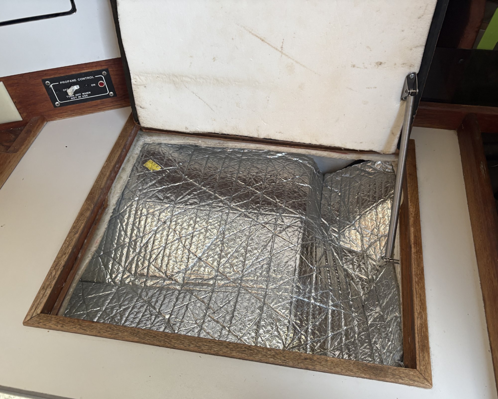

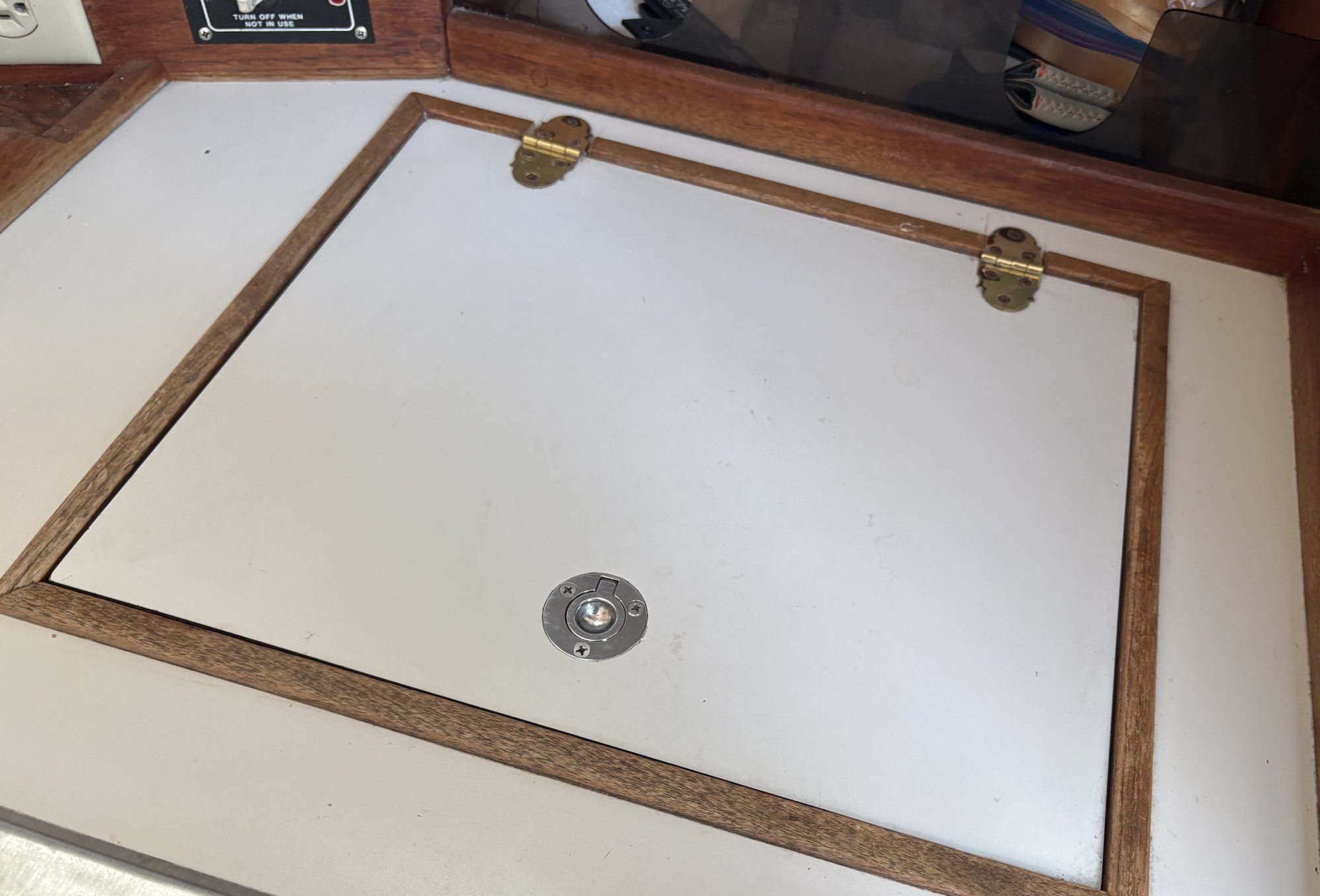

Jan 7, 2011
5,792
Oday 322 East Chicago, IN
Scott’s idea of putting some folded towels on the counter is good. I have done that too.
But when put some Refexite in the top of my fridge, my condensation problem went away…
