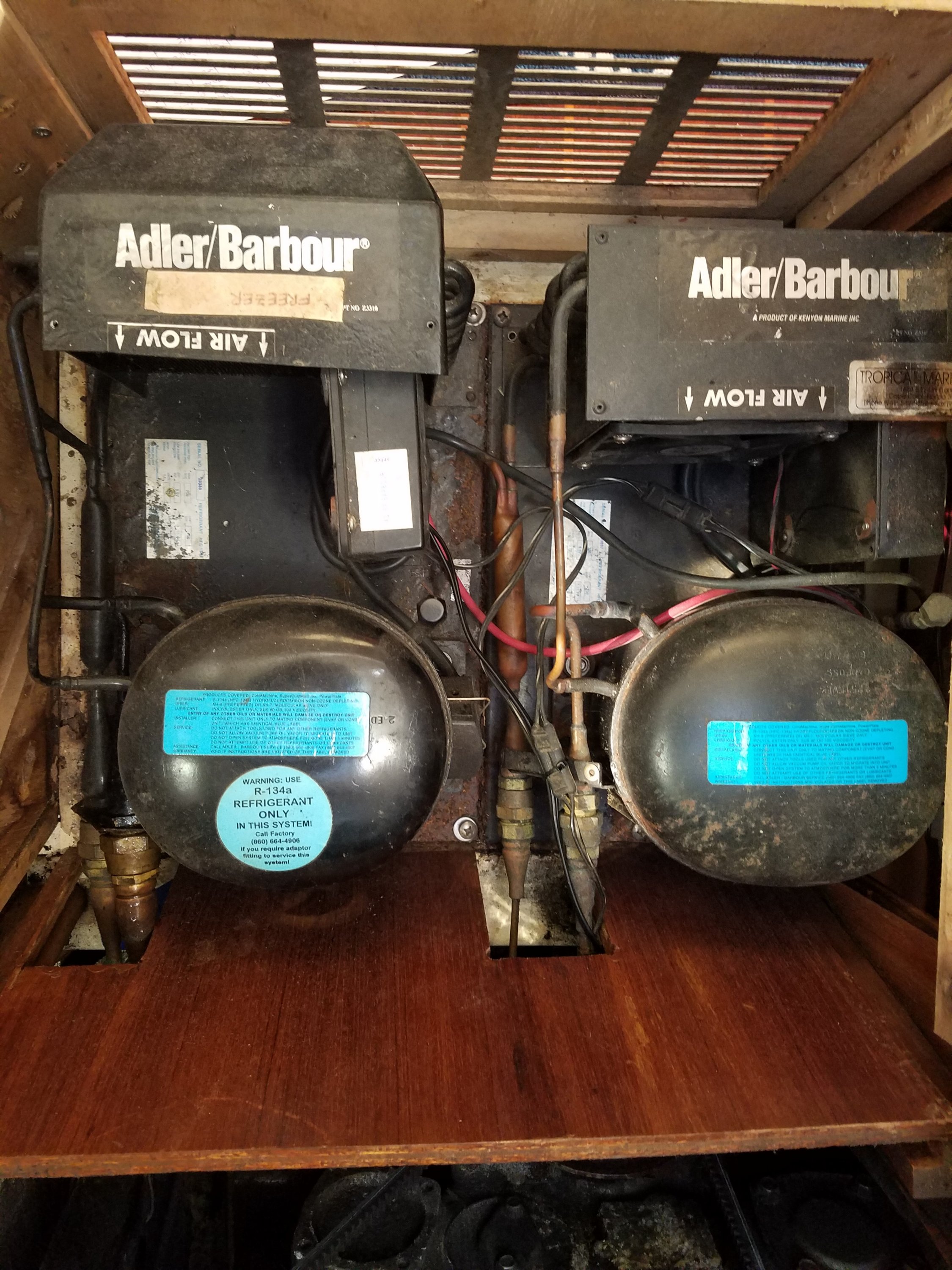

Nodak7 – I have 2 old Adler / Barbour units – one for the fridge the other the freezer. I can't find the model so attached a picture.
