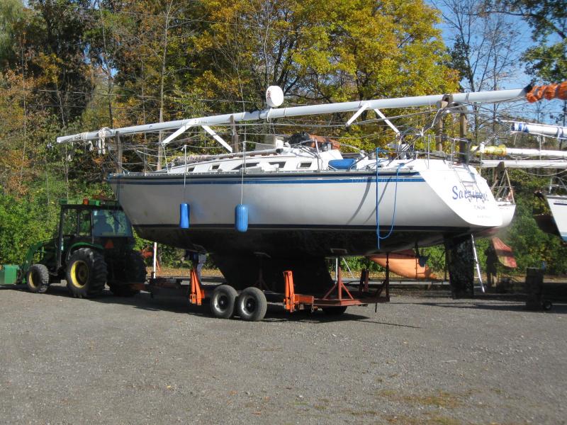

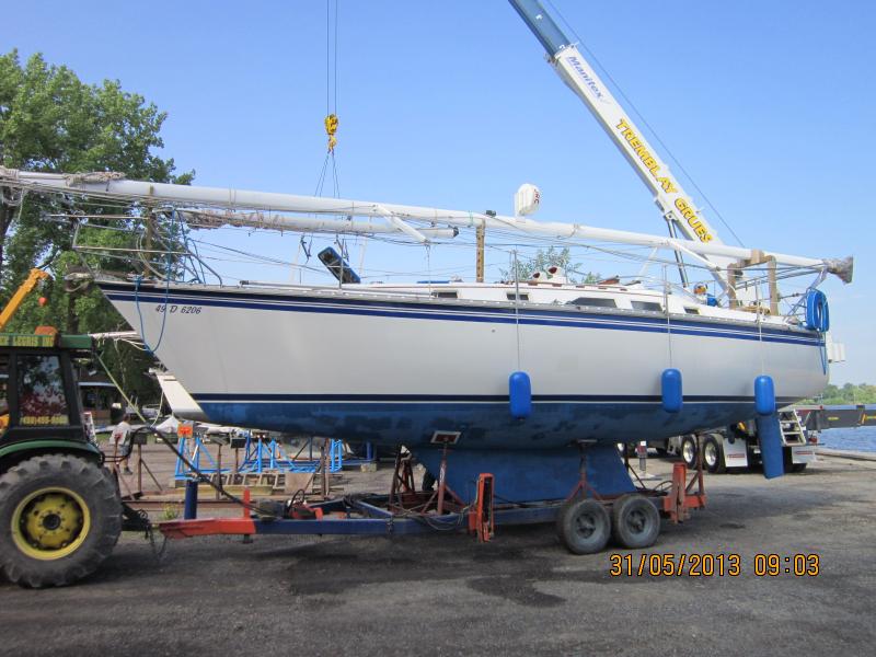

Don is right. Here are 2 pics of my boat on launching day and on haul-out day. Lots of cleaning needed to get that good clean look on launching day. 5 1/2 months in freshwater and boat is used extensively.

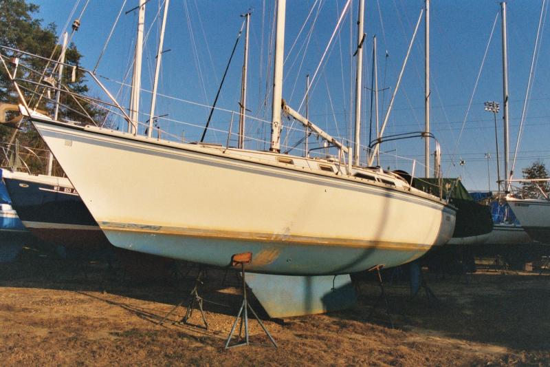

Boot stripe...
On the northern Chesapeake we have brackish water that over the summer season leaves a brown staining up over the boot stripe and onto the hull itself. It comes off with FSR and some elbow grease and is usually another one of those Spring commissioning chores to get the boat ready.
Heavy waxing of the boot stripe barely restores its color, but does make removing the "tub ring" much easier.
Pix is of the boat hauled out for the winter after its purchase. Note how far up the hull the staining gets.
