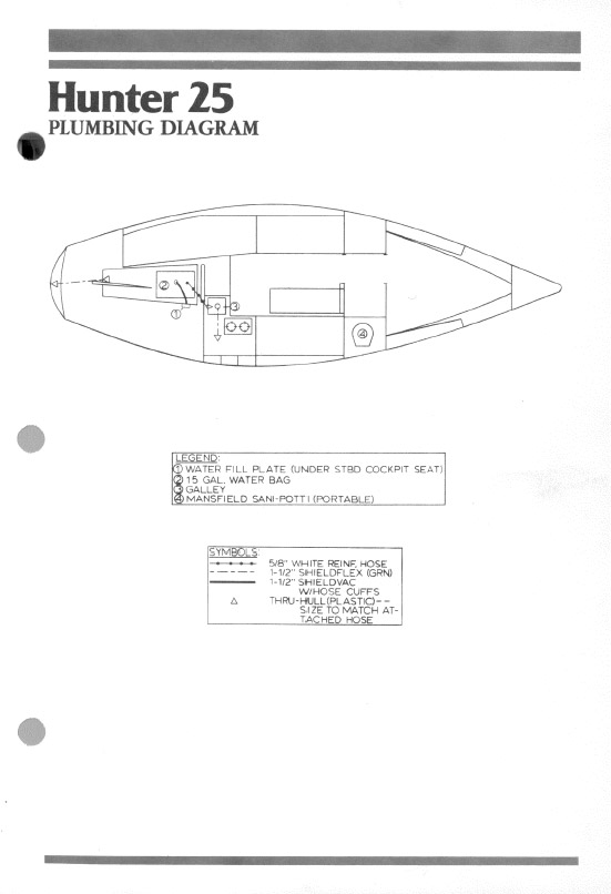

I have a 1978 Cherubini 25, and the fresh water tank leaks. Is there any easy way to get to the tank and replace, or must the boat be dismantled. I can't see it so thus refer to the many experts. Great boat.

Nine gallons....twenty gallons.....I'll take either, just tell me how to get to the tank with out cutting a hole in the starboard settee. Other wise I guess I'll just have to cut. Enjoy the banter though.
Jim; Appreciate the warning, but the locker is solid, and no way in. Thus, I'll make my own access panel using the piece I cut out.Thanks again for all the advice.
Skip, please let us know how it goes with cutting an access hole. I have the same boat, same problem. I found a replacement bladder bag at Vetus.com, but I'm holding off until this Fall to replace the original. The aft vertical surface of my starboard cockpit locker has a small U-shaped cutout, but it is not quite big enough...Have you tried to access under the cockpit by removing the aft port bulkhead (at the aft end of the port quarter-berth/settee? I was going to try going in that way...
As it now appears there is no other way than to make my own access panel, I'll wait until the end of the season and proceed. Another H25, '82 model in a slip near mine, has a home-made access panel made in the locker just aft of the tank filler plug. It was cut and then had the same piece used as a door to the tank. Again, Thanks for all the help. When done I'll enclose a picture.
Skip, I examined my H25 last week (7/10/03), and it looks very likely that the best way to get to that bladder tank is by removing the aft bulkhead inside the cabin at the aft end of the port settee. I'll let you know in a few days whether that works out for me...
