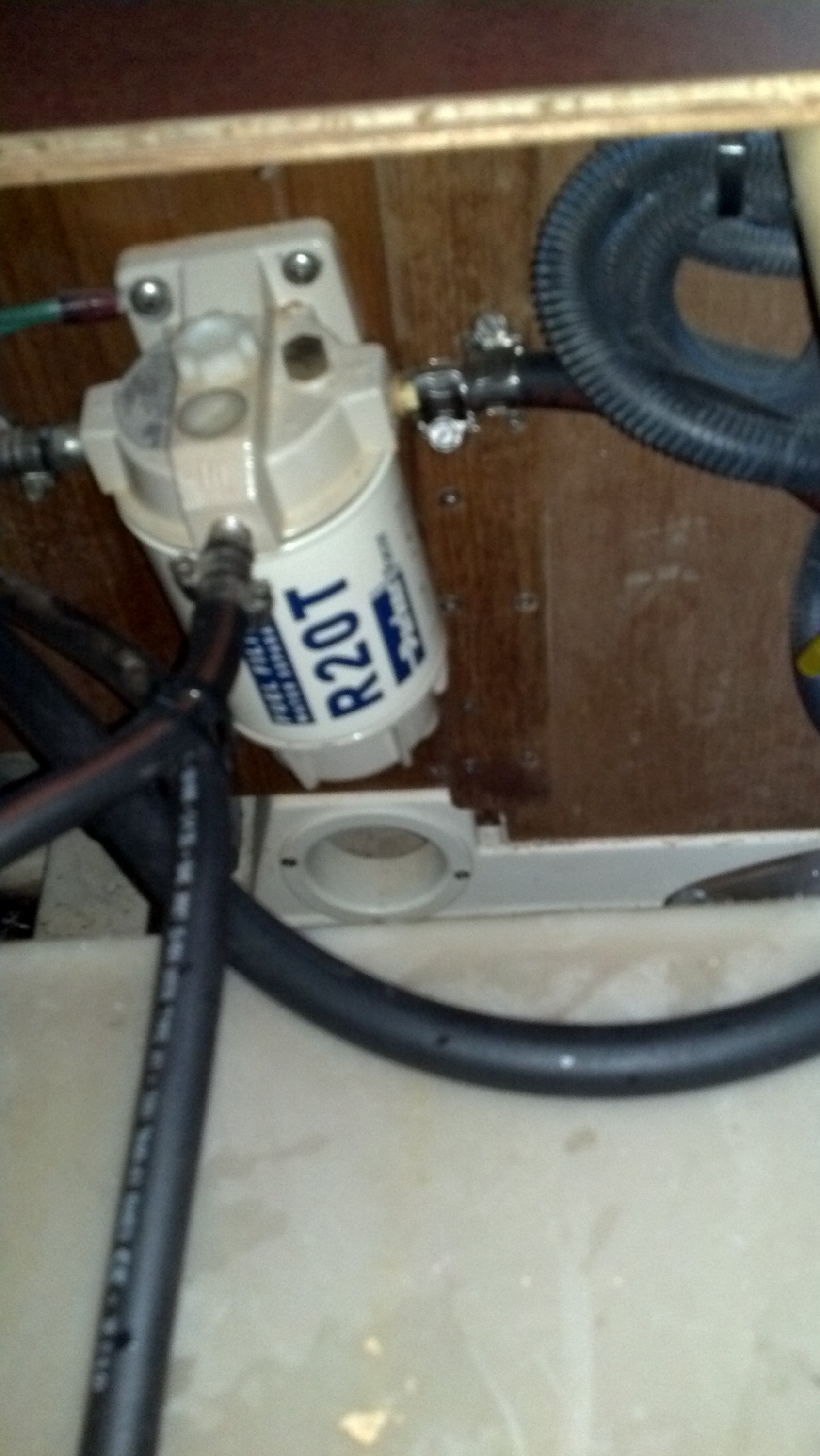

My Hunter 356 has the Racor fuel filter under the bed. My fuel tank is under there also, so it is between the tank and the engine and generator. I use a zip lock under when changing it, then transfer all into a small bucket. Not ideal, but haven't spilled fuel or had diesel smell after removal. Next time I change, I'm going to put a spacer on the wall to give me a little more room between the wall and the filter.
