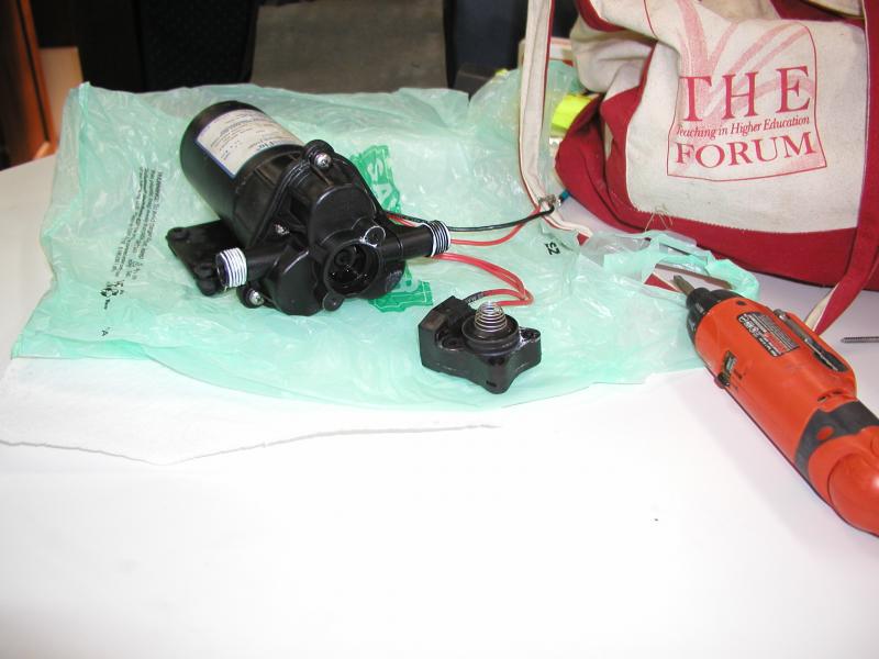

10,214
ShurFlo Pressure Switch
Here is a picture of the switch on an older ShurFlo .. The spring is on a rubber diaphragm that seals the piston that throws the microswitch.. If the switch itself is bad, they are standard Microswitches .. don't remember the exact one, but Radio Shack has some ;
http://www.radioshack.com/nte54-421-switch-snap-action-spdt-10-amps/55050572.html#start=127&sz=12
A quick check would be to short the switch wires momentarily .. if it runs immediately, bad switch or sticky piston.. if it still grunts before starting, might be sticky or bad brushes in the motor.. Good Luck, Phil.
