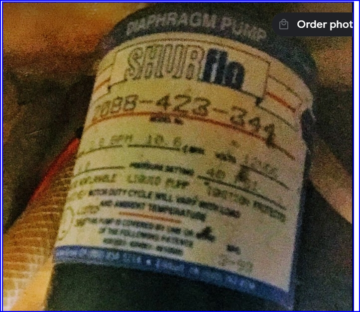

I have flushed and sanitized the fresh water system in the old Cal, but the noise of the pump seems pretty loud. The pump image is here:

Seems like thats normal. The pump may be somewhat noisier simply because its older. The pumps in my boat were noisy from day one, an could be heard even though they were either under a cabinet, or behind a settee.
13,458
Sounds a little loud, but not excessively so. Pump noise will vary because of how it is mounted, what it is mounted on, and where it is mounted. Usually pumps are mounted on some kind of rubber feet that helps to keep the noise from reverberating. A pump in an empty cabinet will also sound louder because there is nothing to absorb the noise or break up the sound waves.

On my 340 the pump in located under the seat at the center table, just in front of my water heater. There is no insulation in this area and in it does sound loud. But no louder than yours does. Lots of room for echo in there. It’s mounted on rubber feet (as dlochner has described) and I placed a soft foam pad between it and the bulkhead. It quiets it somewhat but not completely.
My water comes out a little faster than yours does, but that’s GPM sizing.

The pump noise is the pump cycling. The cycling is caused by the pump's built-in pressure switch that kicks the pump on when the pressure drops below a preset pressure of ~20 psig the pump turns on automatically to bring pressure up to its preset pressure, typically 40 psig. An accumulator on the pump discharge could mitigate the cycling.

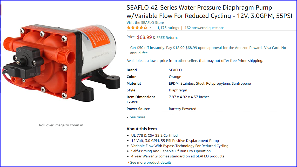

Do any of you have a variable speed pump or "heard" one in action on another persons boat? I see something like this on Amazon and wonder if it's any quieter.

The Seaflow 42-series pump 42-Series Diaphragm Water Pumps - SeaFresh Marine - An Authorized SEAFLO Dealer has a built-in pressure switch that automatically starts and stops pump when faucet is opened and closed just like the . They claim there is no need for an accumulator tank and no pump cycling. I have a Jabsco diaphram pumps that also has a pressure switch that turns the pump on when the pressure drops to 20 psig without an accumulator tank and minimum cycling.

Sounds a little loud, but then again, so did the water running in the sink.
good news is that it appears your accumulator tank works.
you can check to see where the pump is mounted…if on a hollow piece of wood or fiberglass, it could be made quieter by using some rubber pads under the mounting feet or moving to a more solid mounting place.
but, I would not replace it (if you do, send me the old one)…

It’s mounted upside down to the plywood in the vee berth in a space next to the water tank. A bitch location to access to determine if the feet have rubber vibration isolation installed.
