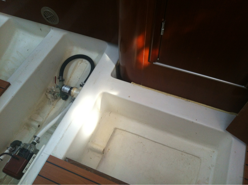

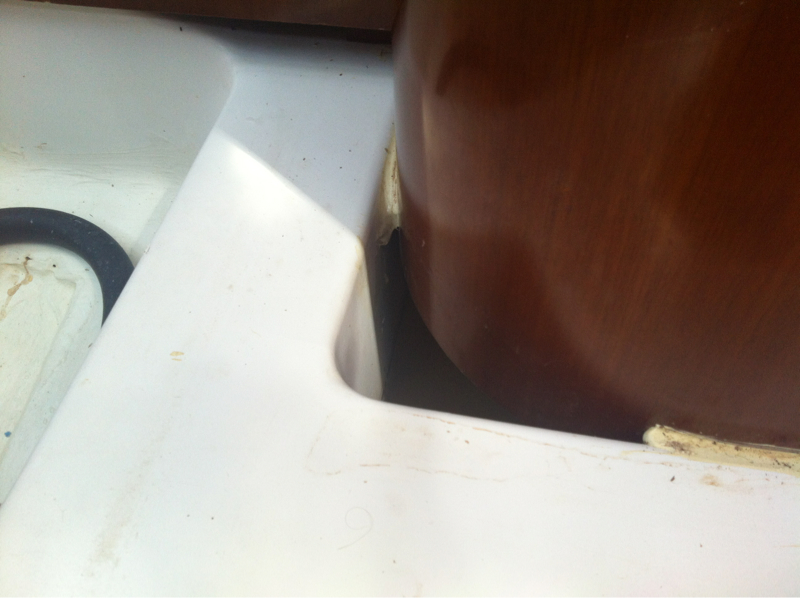

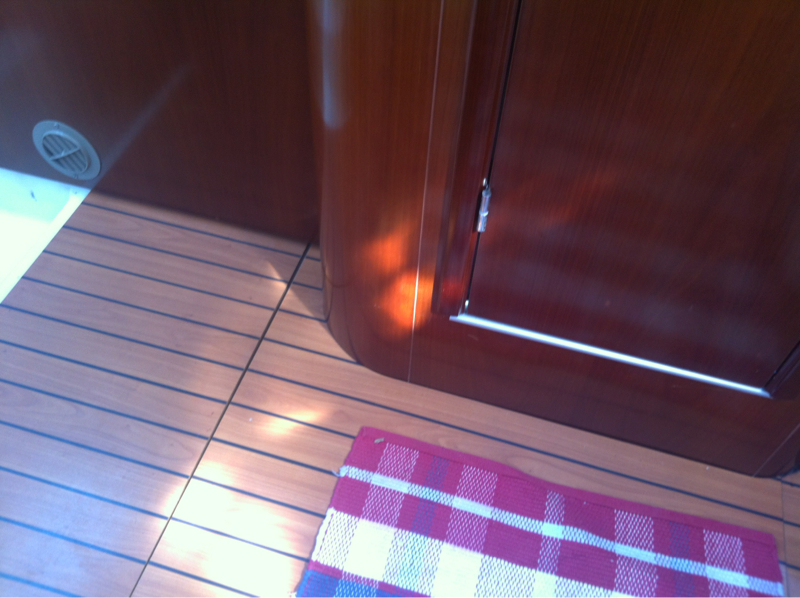

On a side note, how do I get water out from under the starboard side head? When I took the floorboard off that covers the round edge around the head, there is water under it that does not drain to the bilge. See pics! Any ideas? -BCD

I shoved a small camera through one of the limber holes in the hull bracing. All those egg-carton liner braces interconnect. If there is a way for water to get into a section it will eventually find its way somewhere else. Takes forever to get a few gallons emptied out of the shallow bilge on my 343. I switch on the bilge until I hear it sucking then shut it off. Do it about 7 or 8 times to get most of it out. Only way I have gotten completly dry was to pull up all the flooring and vacuum it all out then sponge it off. Trouble is during the winter the floor boards swell such that they wont come out. I am considering removing them this winter and storing. Throw some temporary boards in to get around the cabin.
