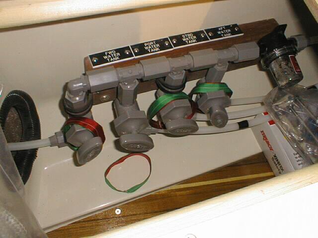

We have four water tanks in our h40.5. A 40, 30, and two 20 gallon tanks. They are connected to a manifold, each with a valve. We rotate the tanks and try to use one of the 20 gallon tanks last. When we go onto the last 20 gallon tank we try to refill asap.
In order to keep track of what tanks are full, which are empty, and which one is in use, I made a double-sided red-green nylon band that slips over each valve. A full tank shows the green side of the band, an empty tank shows the red side of the band (just turn inside-out) and the valve with no band is the one in use.
Simple.
