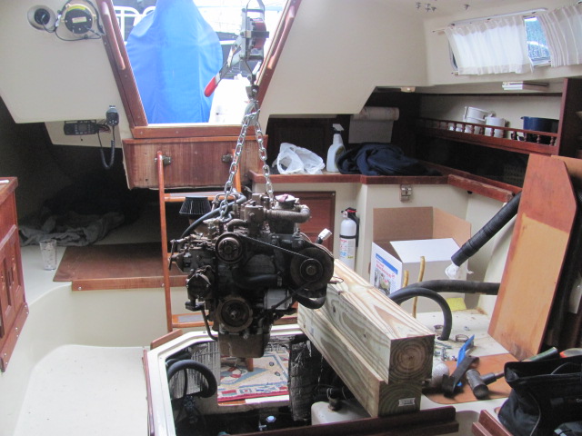

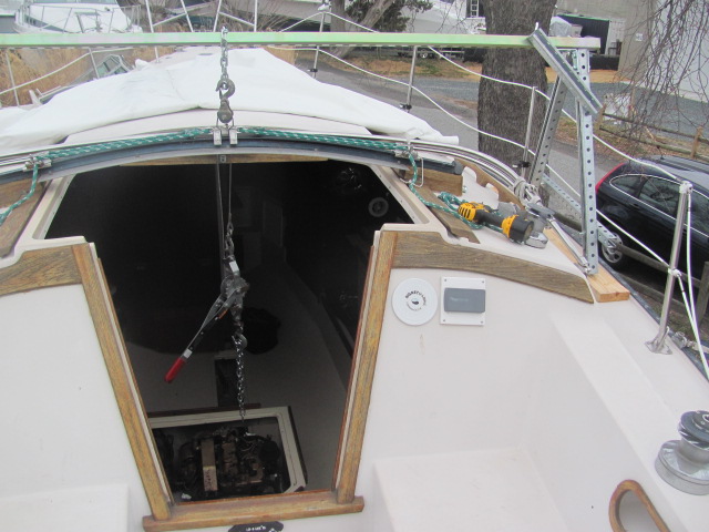

Bob, that motor is only just over 300lbs. It'll come out in a jiffy. The galley cabinet, some hoses, some wires, some bolts. A come-along, and lift away. What's the idea for serpentine pulleys come from?
