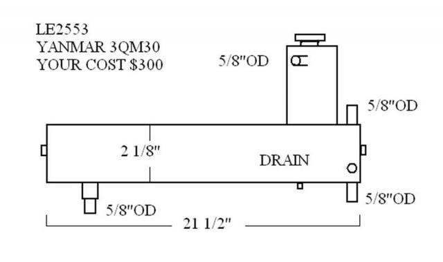

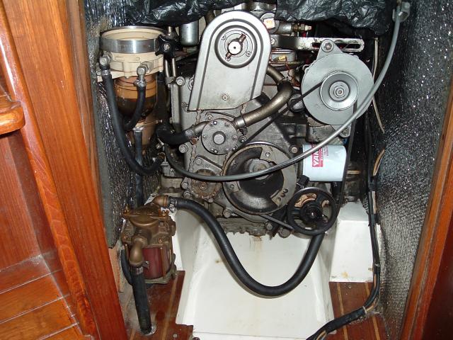

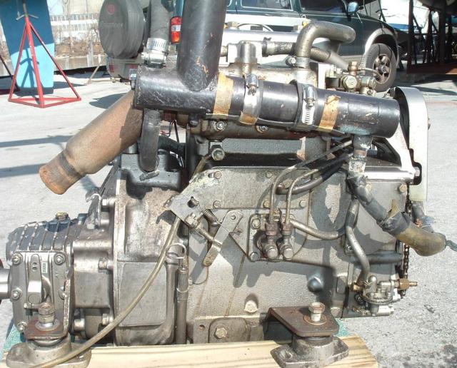

Fresh water conversion of 2QM
My old 2QM20 was converted by a previous owner. The heat exchanger was still available a few years ago when I was looking to convert a 3QM30. But I cannot tell you where I found it. The other expense is the pump. These parts are clearly seen in the accompanying pictures.

thanks for the pics ED ......i am wondering how that worked keeping the hot water tank for the fresh water system ......and did you have any complantes with the conversion....

You don't need a brand specific heat exchanger, just one big enough to handle the engine. You will want a cooler thermostat, 160 degree. As long as you can figure out the plumbing and a way to bracket the monster securely, it's no big deal.

140F vs 160F Thermostat Housing - QM Engines
One item to include in your decision tree is that the QM series exhaust manifold for the raw water cooled engines will only accomodate the ~140F thermostat. The ~160F thermostat won't fit. My 2QM20 was converted by a PO from a raw water to a coolant system by the addition of a belt driven pump and an externally mounted heat exchanger. I tried for a while to seek out a way to increase to a 160F thermostat, but nothing came up. I mention because if one reason for the conversion is to heat the domestic water, keep in mind that the heat content provided to the water heater by the engine will be lower than with engines that are designed from the get-go with a self contained ~160F system. When idle, the anti-freeze flowing into my heat exchanger from the engine becomes very warm, but not hot enough to burn a finger-tip.
As to engine temp and performance, all I know is that the ~140F 2QM20 has been powering my boat since 1980 and its still working just fine.
