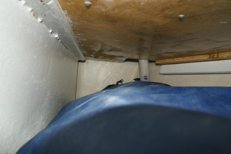

A pair of 30 gallon bladders work well in the space under the v berth, add a diaphram pump and life is good.

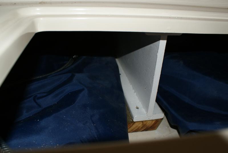

Dewhunter.... What is the support shown in your picture? Is this just to separate the locker? Are the bladder tanks connected or do you switch between them?
Sep 28, 2008
66
Hunter 26 Ghost lake

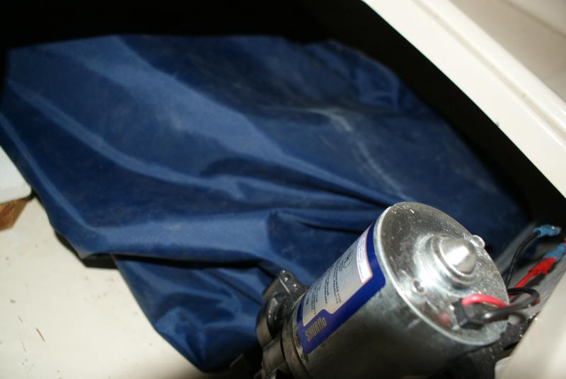

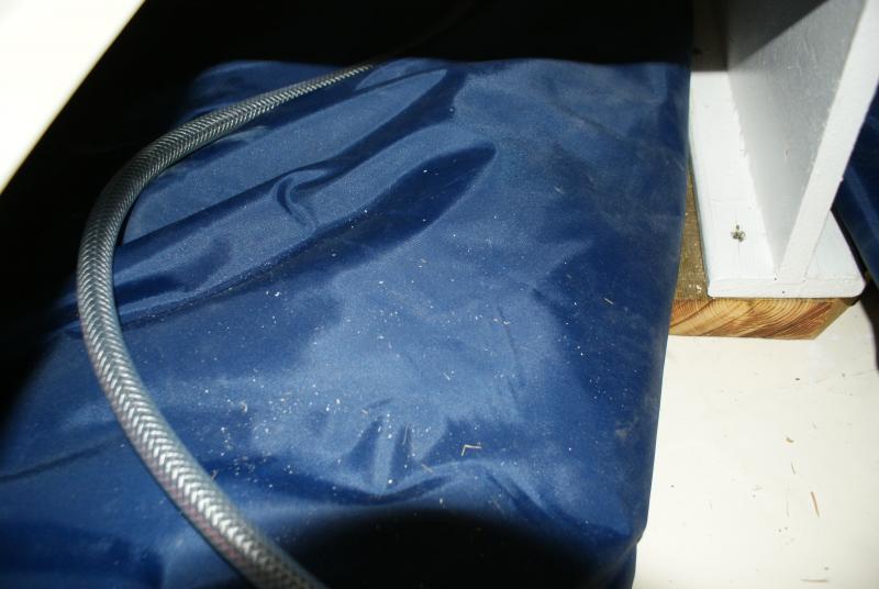

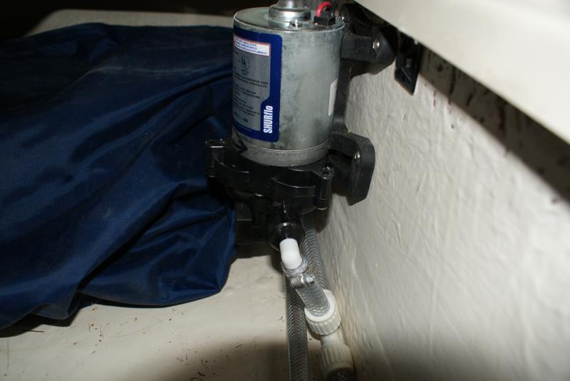

The support is just that, it holds up the center of the bottom platform on witch the 110L freezer is set. The sides are enclosed giving storage compartments on the port and starboard sides as well. This is all under the vberth in that big emty space. I don't have really good pic's of the job, I'll take some the next time I'm out at the boat. The bladder tank came from WM and has a common fill located on the bow deck behind the gib furler with tee'd common connection to pump. The water tends to self balance so I have never had a list even after an 8 hr sail.
