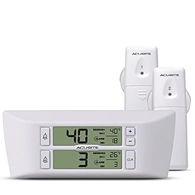

You can observe the current temperature and record the maximum temperature with one of these inexpensive units.
AcuRite 00986M Refrigerator/Freezer Wireless Digital Thermometer2
AcuRite 00986M...
