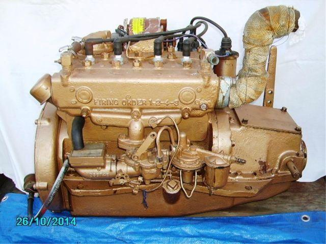

10,152
Jake has it on this one, I think.. A picture of the Atomic 4 shows the exhaust manifold "freeze plugs" as being convex side out with a distinctive punch mark in the middle to expand the sealing edges.. Most engines have the concave side out, so the confusion.. The lip or stop in the hole that the plug goes into is the determinant.. if a lip, convex out.. if no lip, concave out.. The Yanmars and Kubotas that I have played with all have concave out..
