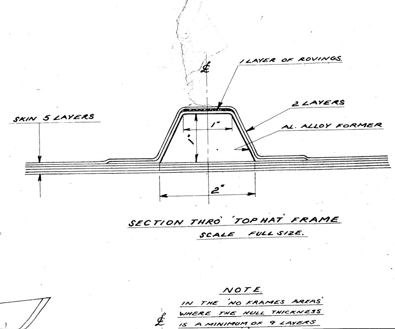

One of the plans I got from Niels is the "standard reinforcing & hull layout". It shows a cross section through the "top Hat" frame showing the base (against the hull) to be 2", depth 1' and tapering to 1" wide on inboard side. 2 layers of glass with an extra layer of roving on the inner face. It also point to a seperate inner mold(?) referenced as " AL. alloy former". It seems there was an aluminum frame or pattern used to shape the top hat. In the drawing this lays flat on the hull with the glass over it. I just don't know what 'former' means. If that was true only in previous hulls what did they use to replace it? The date of the drawing was 28-2-61.
It also details the deck to hull arrangment and it is hard to imagine how water would get into the hull there. There is a 2" flange on the hull, with a step down or rabbit that the deck lays in.this is 1" wide and about 1/4" deep. The toe rail overlaps this joint by over 1/2". Water getting in here would appear to have to run down the joint and into the interior. Where it could go is in way of the holes drilled for the toe rail bolts and run horizontally about 1" out board through the hull flange and then down into the topsides. Sorry about my description- don't really know how to describe it! What I need to do is some how scan and then post it. I have no scanner (zapped by a voltage surge) but we do have a copier and fax here in the office. I'd be glad to share/fax/ send copies if any one is interested.I got many of the plans from Alden and am tempted to get all available ones before they go to MIT, if they haven't already.

Thus, you can see why no 'glass boat builders use frames and few sailboat builders even use stringers. Interesting using aluminum 'formers'. I'd bet the aluminum you describe is just exactly that, a former, and the 'glass is the frame. What guage metal is it? Is each aluminum former continuous? What's the crossection of the former? Clearly, a half-round shape would be harder to locate while glassing but would be better since the glass frame would be bonded to the hull nearer the 'webs' of the frame.
If you were to run the numbers on a panel made like the Challenger hull, I'd bet that the frames don't add much. Compared to a concrete double tee parking garage floor, with its post-tensioned steel strands, the amount of longitudinal fiber at the inside of the hat is pretty small; it would not move the neutral axis very far from where it would have been in a heavy unreinforced panel. Ditto the plywood deck 'beams' in a Challenger. Better than nothing, for sure, and all the more effective the thinner the panel is.

The frames are on, maybe 10 or 12" centers? What weight roving? Just out of curiosity, I'm gonna' try to get it calculated. Judging buy the note '5 layers where there are frames and 9 layers where there are none', the designer was counting on useful effect. Not much longitudinal fiber at the bottom of the hat, though. Imagine the difficulty cutting and placing the strip of roving reliably!

Those hats have a huge influence on both stiffness and strength. At a 12" spacing, they were probably following Nevins' Rules or other classic wood yacht scantling rules as a guidepost, and designing a laminate and framing to be equivalent. Knowing what my mentor did in this period of time, the analysis would have been carried out using the "1 inch strip" simple beam formula for the unsupported shell spans (12 inches) and the hat section would have been analysed as a composite section a la built-up steel.
Now very importantly, note that the "FORMER" inside the hat section is aluminum. It constributes a huge amount of stiffness to the system, as it is aprroximately 8 times stiffer than the surrounding fiberglass.
Finally, 5 layers of Classic Plastic isn't a thick hull shell. If you built an entire hull out of this laminate, without any hat frames, she'd be a wet noodle, and the furniture etc would pop out.

An Alden Challenger is a glass hull - glass deck - wood cockpit and house - wood interior keel/centerboard boat from the antideluvian period of fiberglass boat building. It is pretty unique in that there are hollow hat frames at about 12" oc for most of the hull. Take a look at the piece of the original drawing and opine whether the hats add much.
I don't think so, but the note saying 5 layers where there are hats and 9 where there are not is suggestive that the designer thought they were useful.
He may have the hat frames and ribs confused. The hat frames and their formers are only about a foot long. I don't think (?) Alden spec'ed the formers inside the hull frames. At any rate, it's good to think they do help in the hulls structure. In the right light angle, you can see the ribs faintly on the topsides.

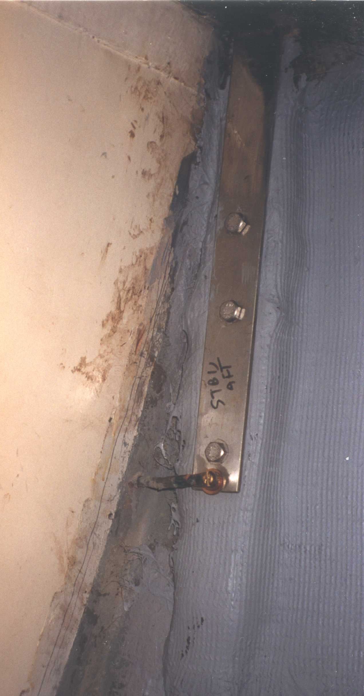

I stumbled onto some old photo Dan sent my several years a go. They show one of his hat frames cut open with the plate removed, another with the new SS backing plate installed and the hat frame re glassed. He had a boat yard do this before his trans atlantic. Maybe he can chime in at some point.
As you can see, hat frames are independent of the "ribs". I replaced one backing plate this way. It was straight forward. It's important that the glass is re done correctly. Next time I replace another (most of mine are fine), I will try just cutting out an opening at the bottom of the hat frame to slide the backing plate out and install the new SS backer.
