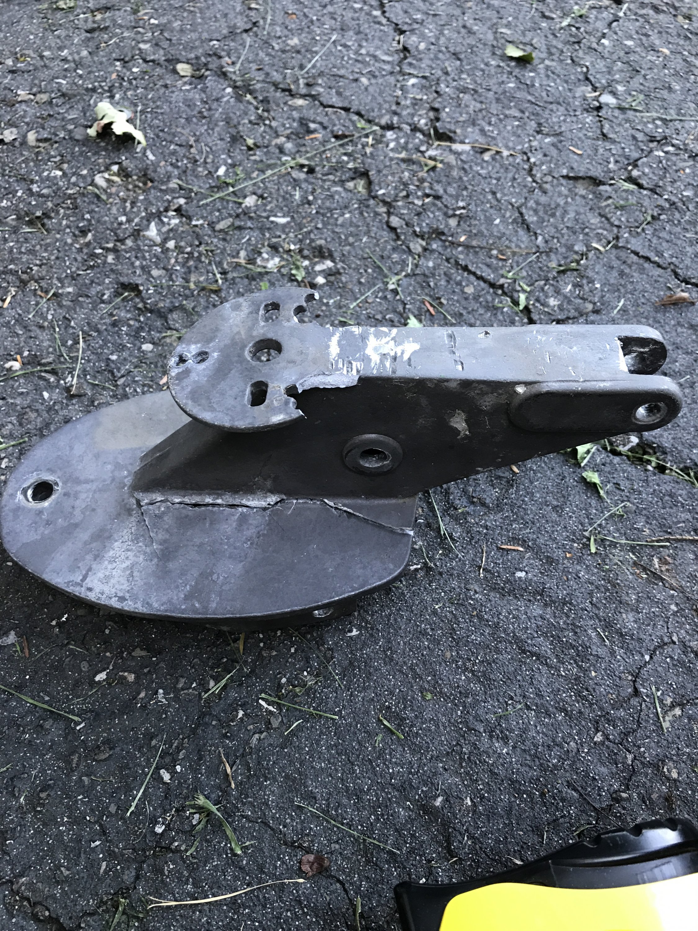

Ok. Something went wrong last Saturday. After sailing in high winds Tuesday, and moving along around 13 knots(!), we determined we needed to tighten the standing rig. The leeward shrouds were sagging. I had not used a gauge, instead using feel and experience. Unfortunately, my experience is with a masthead rig with standard shrouds.
I tensioned the shrouds, equally, but again by feel. I tensioned the backstay which has a big Wichard tensioning wheel on it.

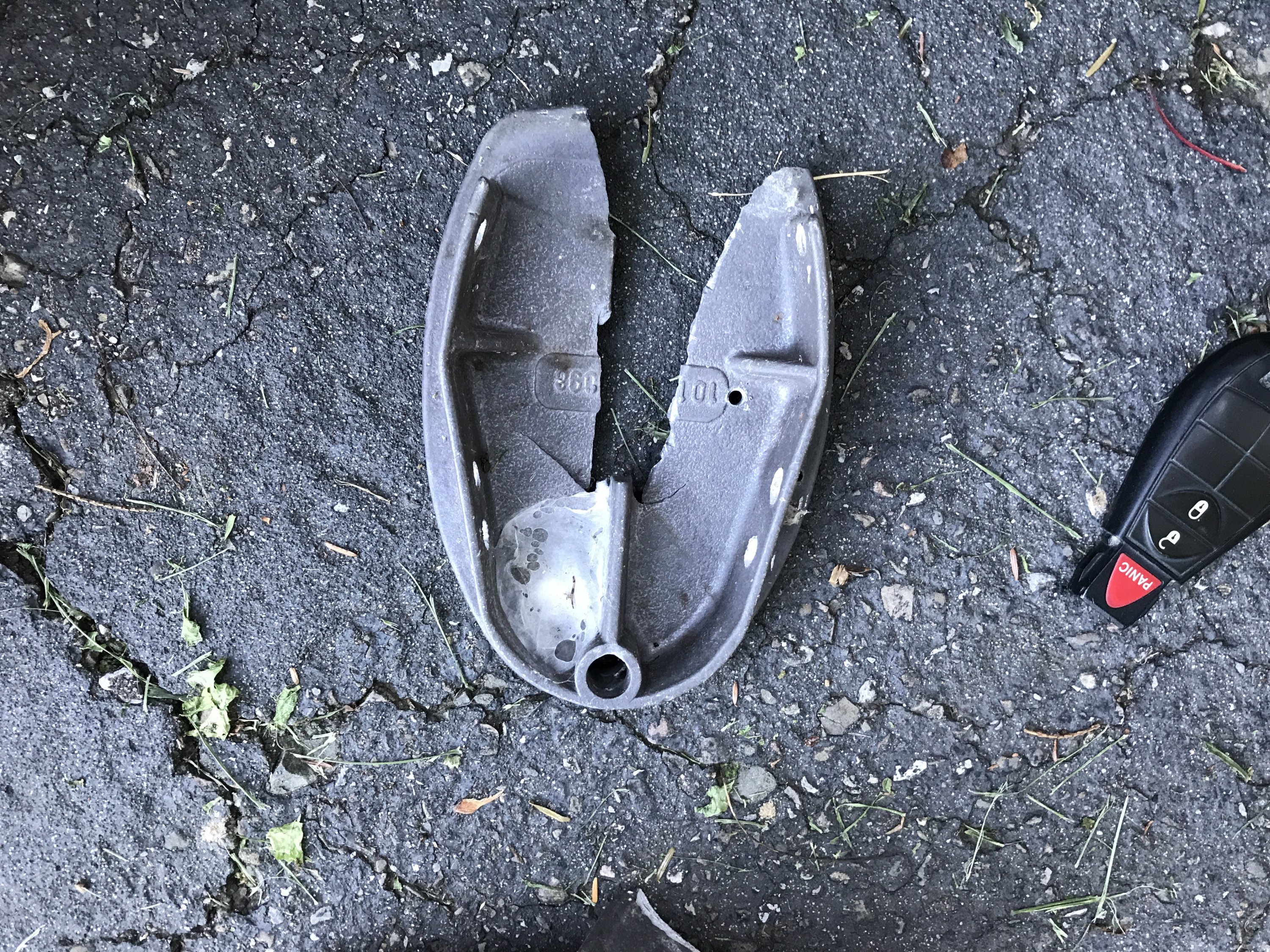

We went sailing, and after just one tack in high winds, going fast enough to scare my friend, we decided to reduce the genoa and flatten the main. I did both, but as I returned to the cockpit, I noticed my backstay... you guessed it, flailing around wildly!
I jumped to the tensioner on the stern, but I quickly realized the tensioner was not the problem. I followed the backstay up the mast, and I found the crane collapsed.
Ok... the design saved us from a dropped mast. The mast didn't move. We lowered the sails, tied off a temporary backstay, and returned to the marina.
So, talk to me about the backstay function in a swept rig... I am on a rather steep learning curve!
Luckily, I had the original masthead welded, and I purchased a new masthead from Rig-Rite. I return to the boat, on the trailer, with the mast unstepped, to install the new masthead.
I would like to know that my backstay is really only for sail shape, so it does not need much tensioning. I would like to confirm that the shrouds in this swept rig support the mast to the rear.

When the mast crane breaks, there's too much backstay. Kidding aside, there probably was a crack or fault in it anyway. I can't see what happened from the pics.
My H356 had no backstay. The mast stayed up - albeit I would have liked a way to increase forestay tension in a breeze. My Mark 25 was fractional and had a backstay. It was a beautiful thing. But you have to adjust your idea of that backstay. It was there as running rigging. In other words it was a sail control and not standing rigging to hold the mast up. I don't know the Telstar but my guess is you could have sailed the rest of the day without that backstay, but you would have been hampered in terms of sail control. It's never a bad idea to return to the marina when gear breaks or you are unsure of the mechanics of the boat.

Thanks, guys. I agree. I realized after attaching a temp backstay that the rig was meant to stand with shrouds. The crane has too much leverage on the masthead fitting to be meant for standing rigging. I could certainly add some support, but then I would be attempting to set it up for something for which it was not intended.

A wheel adjuster can really load up a backstay, maybe too much. A crane should be able to take a lot of load, so maybe your was flawed. But I would get advice from other T27 owners.
