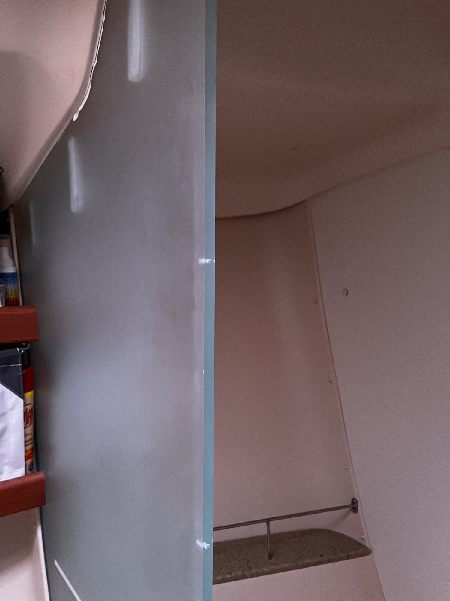

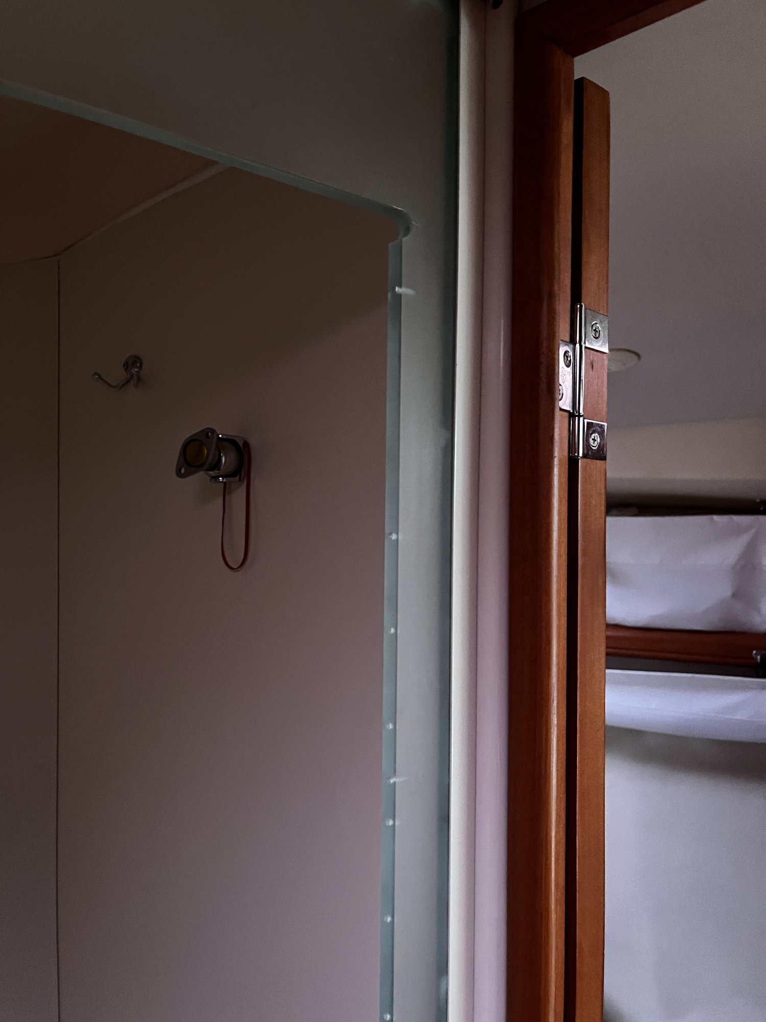

Here are a couple of photos of the shower screen. Not sure how much they will help identifying the material from which the screen is made.
In terms of tools, marcham, I have access to a good workshop with angle grinder, circular saw, jigsaw. Thinking that if I put a metal cutting blade in the jigsaw it might work.

This is acrylic
Use a small circular saw with a fine tooth blade.
Watch your cutting speeds & forces, or you’ll melt the plastic
Other options are a fein oscillating tool, but the line won’t be as straight as a circular saw

May want to try an oscillating tool. They to not tend to over heat the material you are cutting and they are easy to control. They also have a wide variety of blades.

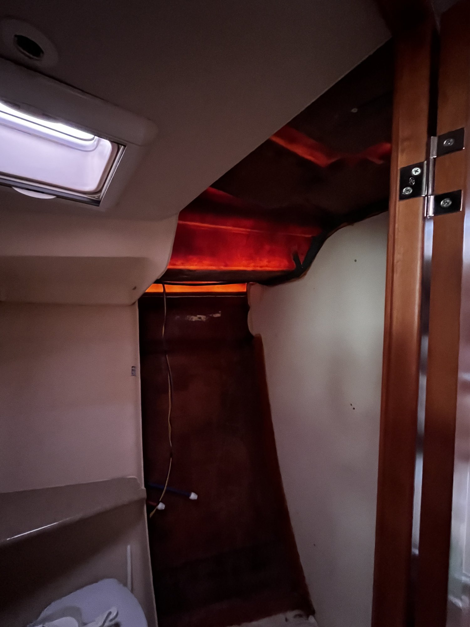

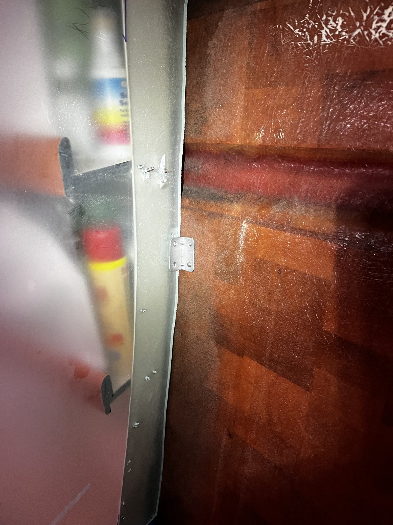

Thanks to all of you for your suggestions. At the end of the day we decided to remove the shower screen entirely. A couple of cuts (using an oscillating tool) in strategic places and we were able to remove it, after removing the headliner piece and the seat/shelf moulding in the shower recess. We discovered that the screen was actually attached to the hull on both the forward and aft sides with a right angle bracket, at about waist height. (See attached photo) We were not able to remove the hull lining mould behind the toilet, so had to cut a small hole in that in order to access the screws holding the screen to the bracket on the aft side. Sorry, I didn't take any further photos during the demolition phase, but I'll post some photos during the reconstruction phase. Attached is also a photo of the space with the screen and liners removed.
