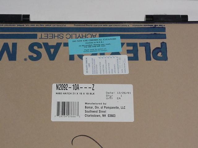

This must be one of the most asked questions on the Hunterowners web site
If you search the site you will find a link thaty goes with this picture
It wasn't that big a deal to replace when I did it you need a small rt angled grinder.
